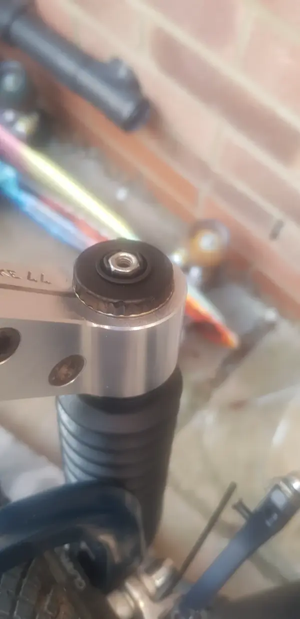

Help with this Rock Shox please
The adjuster is there, inside the damper shaft.
It turns with a 2mm allen key and it clicks every half turn.
Now I understand why the bolt is hollow. 👍
Glad you found it. If you want an adjuster dial I stead of having to push an Allen key up there each time let me know as I'm sure I have one. It fits over the hollow bolt and has the Allen shaft as part of it so you can adjust to your hearts content on the trails without reporting to breaking your tools out.
Sure, please let me know the details (price, postage, etc)
Yes please.
Do you need measurements or are they all the same?
Do you have a gold one like mine?
How much?
Thanks
I will take a couple of pictures and drop you a message in a bit.
All Judy's of this era shared the same stantions so interchangeable. 👍

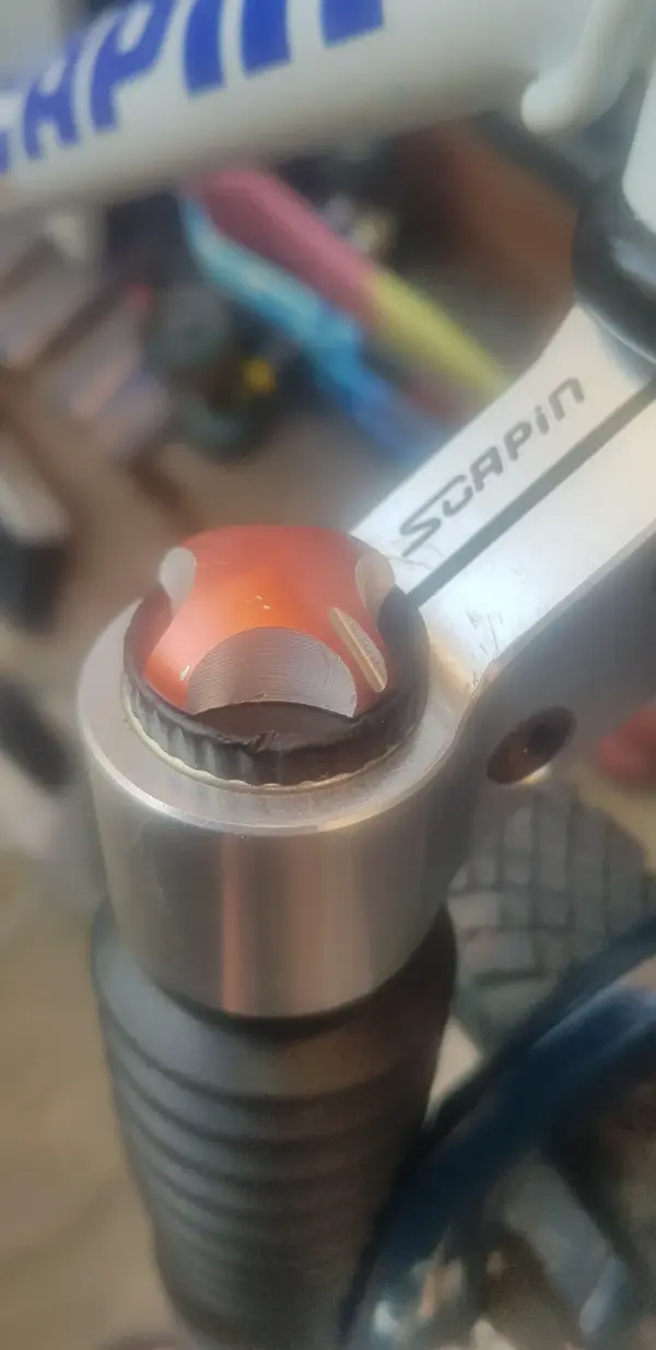

Hi everyone, small glitch with this fork: one of the top caps has popped off and when I went to reposition it, the hexagonal pin that hols it pushes down.
Is there a trick to fit this cap without removing anything from the fork?
Thanks

Ah, ok.
If I bounce it it comes out, but when I try to put that dial back it goes back in.
Can I use clamps to keep the fork compressed?
Initially I fitted both dials before closing the top cap because it's very tight.
