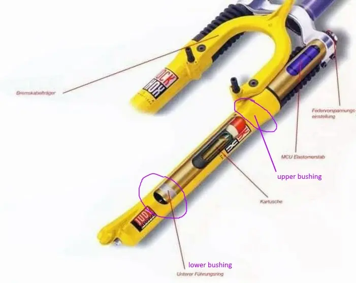

Two bushings on each side, one at the top (you can feel with fingers) the other one almost at the bottom, they are pressed or fix mounted into the casting, hard to see and to me almost impossible to be removed or replaced.
Yes, yes.
I looked inside the bottom legs and in fact there are 2 metal bushing where you said.

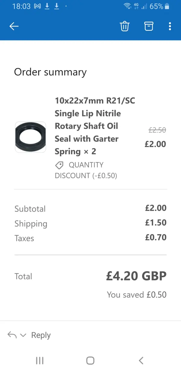

I measured the old oil seals with a caliper and they are exactly 10x22x7.
I bought new ones at £4.20 including postage from Bearing Kings.
The seals I received are identical to the original ones, so the guy selling them on Ebay is way too expensive at over £17 for 2.
Anyway, I fitted them and they are tight, to the point that for the bottom one, after I filled the cartridge with oil and expelled all air, i had to make a "press" using washers and the thread in the shaft.
All done and working perfectly.
I just Need to find a new stanchion.
I hope this helps someone.

By the way, forgive the probably useless details, but the original oil seals were single lip, so I went for the same ones, although they sell the double lip as well.
My thinking: these oil seals usually work with rotating shafts, so less friction than up/down movements.
Double lip might crate more friction with the double lip; is this why they use single?
Or is it just to cut costs? (50p)
