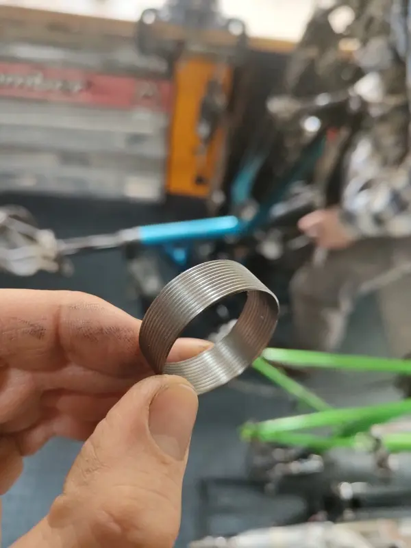

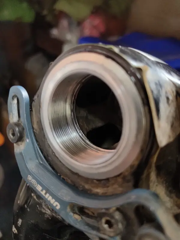

Praise be to @danson67 who completely fixed my frame through his method explained above!
See photos of grinding out the remaining damaged thread using this tool, then inserting the Italian thread, then the finished result! All done in around an hour.
Thoroughly nice chap, and nice to admire all the retro bikes hanging around his workshop awaiting their turn too!

As @Peachy! mentioned above, I have repaired several BB shells by reaming out the old thread to a larger diameter, tapping out to Italian spec,
then fitting a pair of thread repair helicoils.
These are steel inserts that are screwed into the Italian thread, held in with Loctite 638 Retainer, with a standard BSA thread on the inside.
This is the best way to sort it out.
PM for more details if you're interested.
