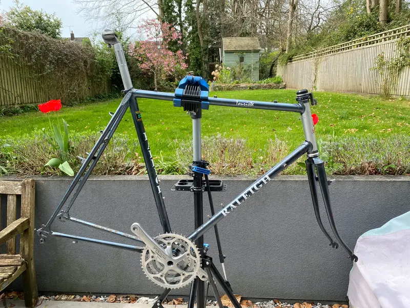

Here is the frame as it was when I picked it up, it had not been moved from the photo on eBay. Fortunately apart from obvious surface rust it looked quite sound with no dents and to my delight it was 60cm c2t and the top tube was a perfect for me 58cm c2c...result.
Here is the frame with most of the bits stripped off. I couldn't find my crank removal tool for the moment so took this with them still in place but everything came off very easily with no seized threads and obviously no seized stem or seat post to worry about. I popped an appropriate seat post in to check size and condition of inside of tube and it was fine and 27.2mm as expected.

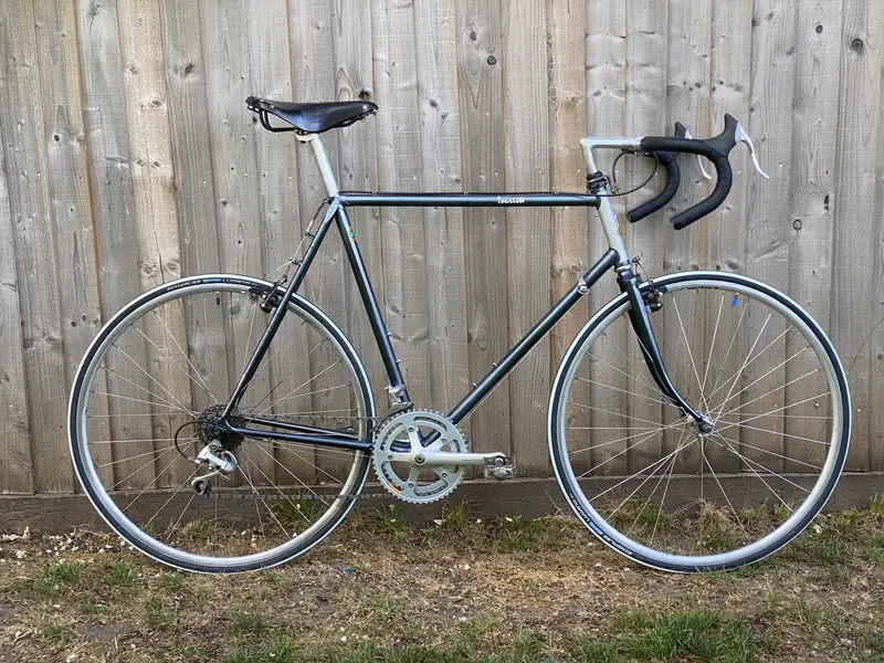

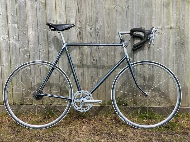

I could not resist a quick mock up using the RSX wheels I have, together with the Brooks that I will use and the bars. I have not decided yet whether to go with the STIs or go for downtube shifters. I have some tektro cantis that I will use and that should be it with RSX front and rear mechs.
Oh, and I decided the "RALEIGH" decals were not attractive so they had to go. Sacrilege I know! I think it looks so much better without them though.
