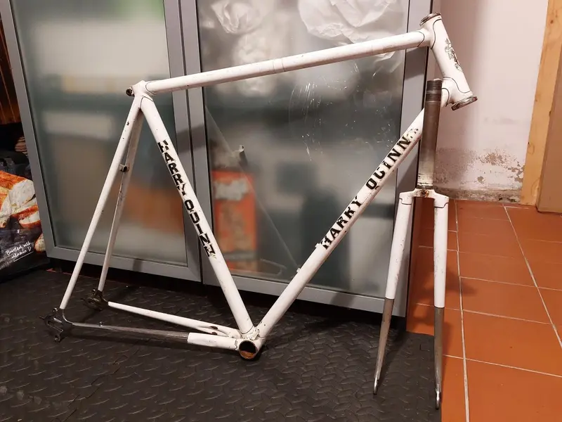

Nice 70s frame, unfortunately came with stripped NDS and not very best drive side either. Pondering what to do, find a solution or find a fellow rider with a bit more of an experience and pass it on?
Suggestions please

Now if there is someone that would take this challenge on, you can have this nice Harry Quinn frameset for £25 + postage. Aside stripped bottom bracket threads there are also
- couple of dents, one under down tube (non visible unless upside down) and on drive side rear stay
- stuck seatpost binder, which can be cut out easily, but I'm applying Gas Plus regularly before doing that
I think forks are worth more than that, but it would be pity splitting them from the frame.
