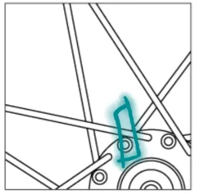

you don't need to move the spokes, you need to turn the hub further before you fit the leading spokes.
to do this, release the tension of everything, remove the leading spokes (head on the back of the flange) twist the hub as far as you can then relace the leading spokes.
