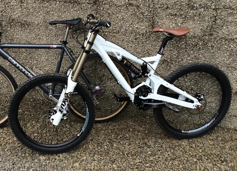

Anyway, here is my 2008/09 Diamondback Sabbath. A DH bike with an enclosed transmission (G-Boxx).
Bought this back in 2011 I think for £1500 second-hand (my college bursary at the time 🤣) Pretty much in standard form. I added a couple of parts to make it mine. A Renthal Fat Bar, A Renthal Duo Stem and FUNN seat.

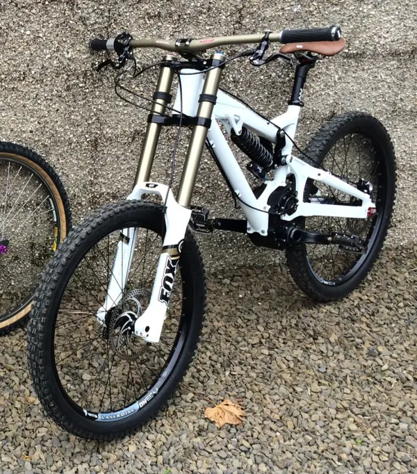

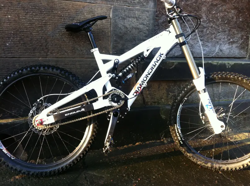

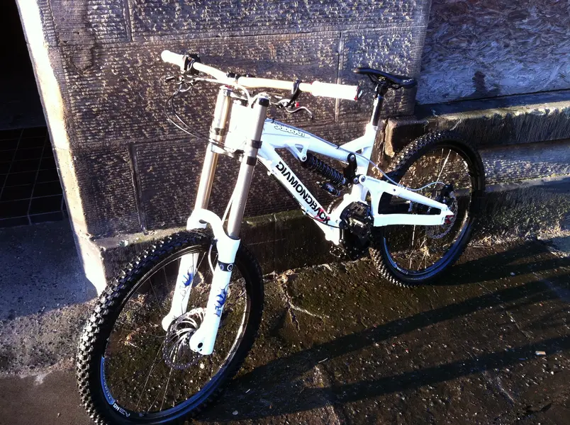

The following year the Gearbox was serviced and at the same time a Works Components Angle Headset was fitted which transformed the bike! Although the 2 pictures below are at slightly different angles, i think it shows just how much the angle headset slackened out the front of the bike.

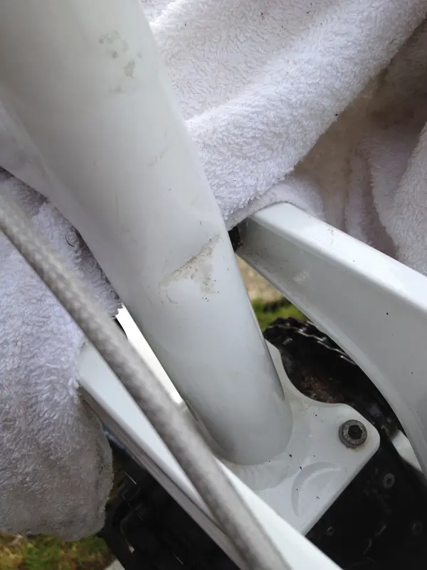

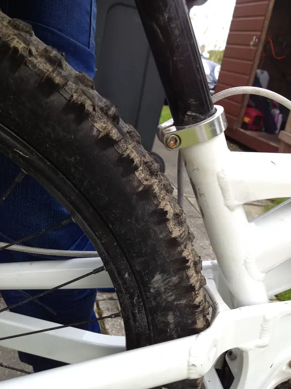

Ran the bike like that for a year or so until I had a bad bottom out on "The Wall" at the Fort William DH track and the shock blew right through its travel, jamming the wheel and swing arm brace into the seat tube. Dent in the seat tube but no other severe damage.

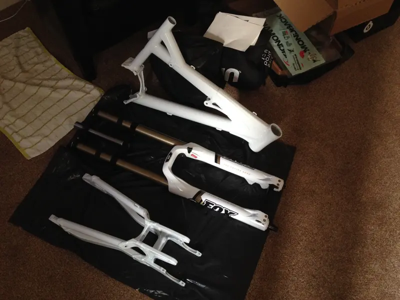

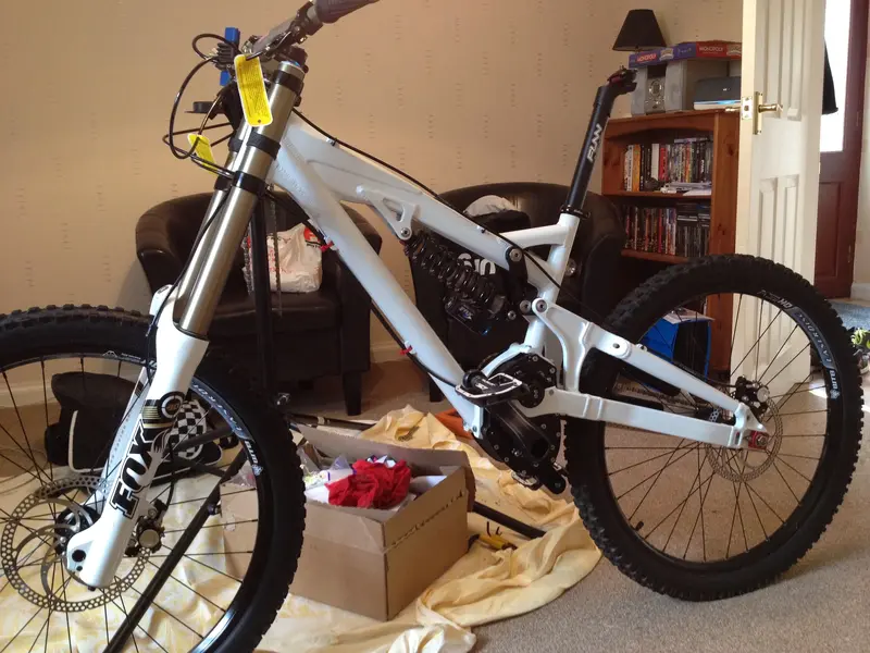

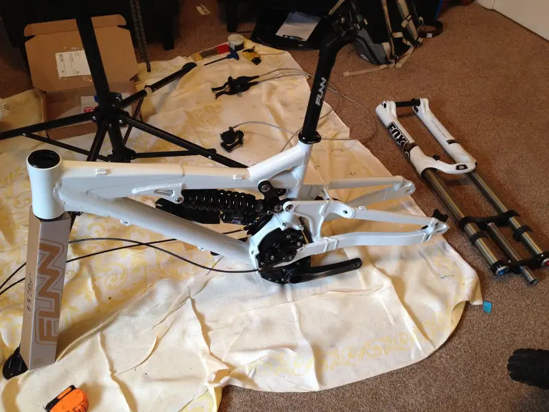

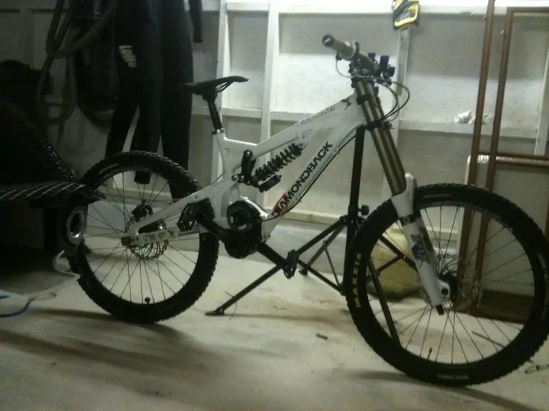

After some investigation, it was time for a rebuild. Frame sand blasted and painted in white again and then rebuilt with a selection of new parts. Minion DHF & DHR tyres, Formula RO Brake Set, Charge Spoon Saddle, FUNN Seat Post, Salsa Seat Post Clamp, Shimano Saint Pedals, New Chain, ODI TLD Grips & New stickers on the Fox 40's. Shock was sent to TF Tuning for a rebuild and again, the Works Components Angle Headset, Renthal Bar & Stem were refitted.
