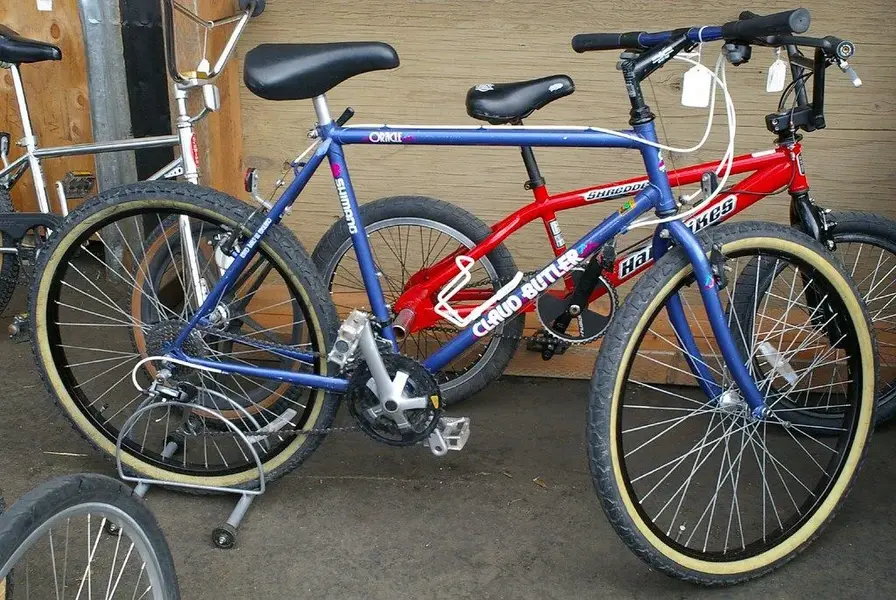

Just for fun / to rule out witchcraft - you could rebuild it with the old spokes.
Have you or any riding buddies not got a single photo showing any part of the wheel of this bike at all?
Nope no photos.. The bike is a
Claud Butler Oracle 92/3 shimano 200 GS groupset.this is a stock photo. Cant really see very well the spoke pattern
