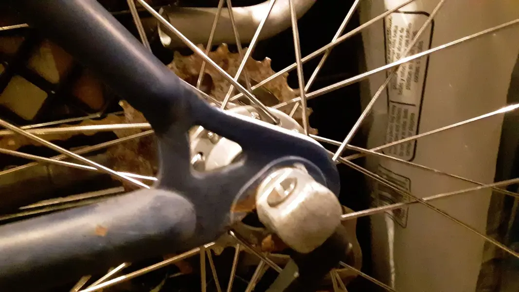

-rear dropouts
The triangle hole makes the frame chromoly. M2 frames have solid dropouts.

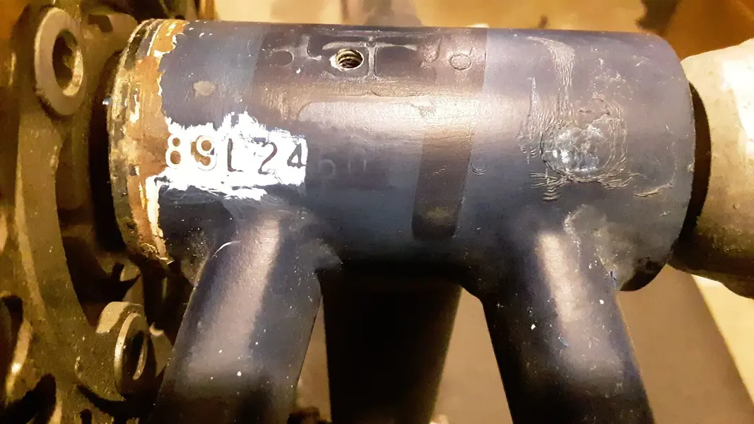

Frame is definitely made of steel. Third digit in serial is an "L". (see attached pics).
I used acetone to wipe paint from the dropout, no evidence of grinding anywhere. Original paint was white.

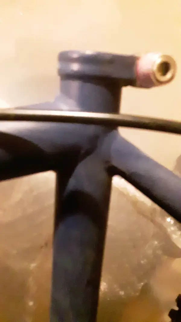

Frame does not have a cable noodle for rear brakes, no evidence of being ground off either.
I believe this bike originally came with the white Judy fork currently installed as it is a 1" steerer and evidence of white paint under that crappy
blue make-over.

*the serial number, from what I can read, the black paint at the BB makes this a bit hard to read

I think you've got an S-Works Steel. Rear dropouts are the giveaway. Year - hard to know but '93 to '95 for sure. Nice find though, shame about the shitty respray!

I should of looked a bit more carefully at those dropouts, but yes the cut out is less elongated than an S-works Steel and the seat and chainstay ends are rounded rather than with a flatter end profile. And of course the noodle being omitted. My understanding is that S-Works wasn't a separate brand until '93, everything until then being a Specialized model, so if this frame is earlier than that then it'll fall into the Stumpjumper or Rockhopper camp. Given that this frame is missing the noodle or another type of brake cable hanger would suggest that the hanger was one of those which was attached to the seat bolt / QR itself. A quick scan of the brochures shows this was common in '89, though confusingly the Stumpy Comp from that year has a welded on hanger! The lack of dropout eyelets is also confusing. I think these have likely been ground off very neatly as they came on every frame except the S-Works steel and the Epic Ultimate, but could be impossible to tell now.

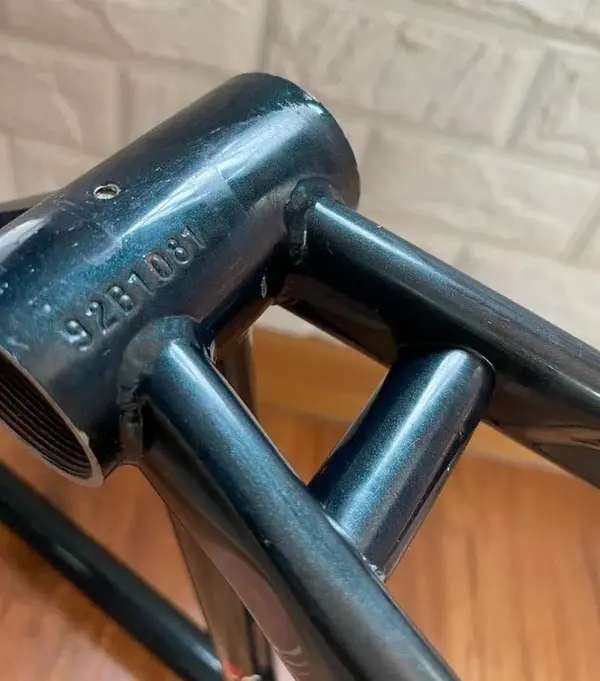

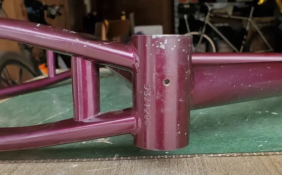

Found two pics of serial numbers in the same format on bottom brackets that run horizontally on the BB. Appears S-works had the year stamped in the serial numbers on the S-work steel frames. So my frame was made in 1989. My wheel/hub parts are late 1980's as are the shifters.

I removed the paint with acetone in those areas, there are no grind marks or previous weld spots, no eyelets and no welded hangers to speak of. In fact white paint was still there and it looks like Pearl White paint, very indicative of a Stumpjumper. Now I am thinking this was one of those in-between transition models that was a Stumpjumper S-Works before it became S-Works in 1989.

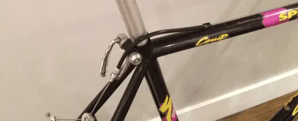

The one in question at this point in the thread hasn't got a rear brake bridge on the rear seat stays, as per this 89 Comp Stumpjumper which had the rear brake cable hanger threaded through the seat clamp bolt.
Here's some pics of @Sergio1069's Steel S Works which just closed on ebay. A 1991.
