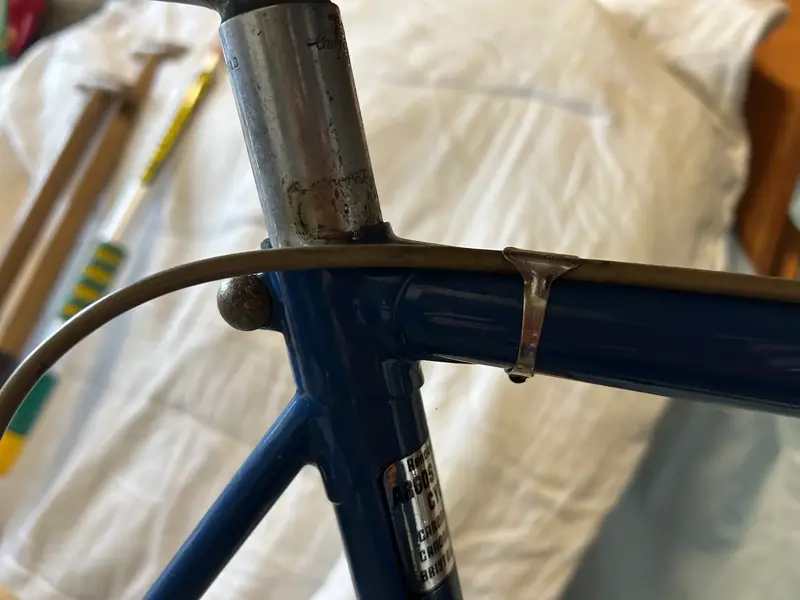

In addition to the Viking, there is an also an Argos liveried frame. My belief is that this was originally purchased as a Fred Baker in Bristol sometime in the late 1960s or 70s. From the serial number (and I presume size mark) under the BB shell, I presume this is a continental frame imported and sold through FB.

That looks like a nice frame and bike, lots of potential.
thanks for sharing the "Argos"
am able to see nothing suggesting the continent
but then your eyes are the ones on the scene
combination of Brampton Victor type seatstay arrangement, full sloping crown, those housing stops and the narrow triangular no-slide pib scream "UK" to my eyes
if chainstays happen to be rapier pattern that would clinch it - cannot tell from images provided
headset appears to be Thomas D. Cross & Sons Ltd model "S" -

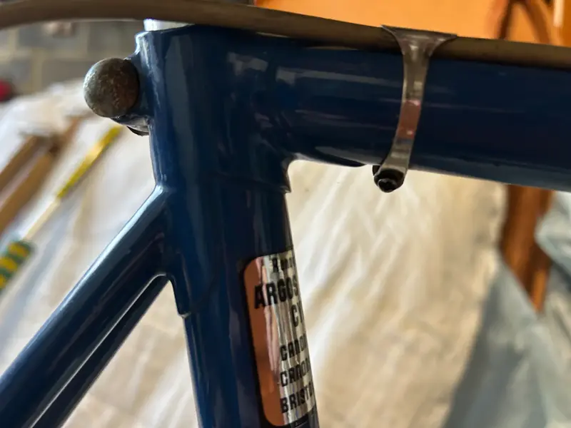

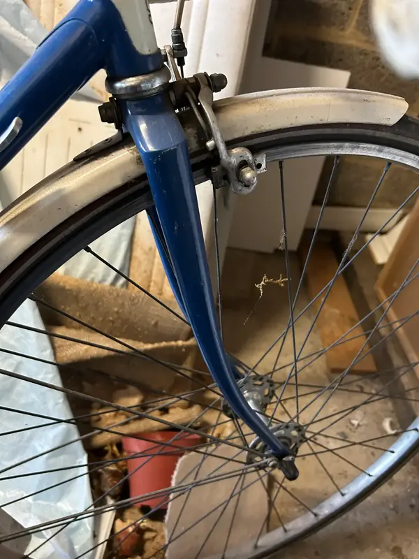

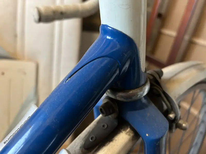

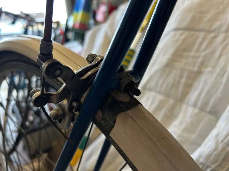

Some more of what I took. The only thing I had to go on was the serial “F9437” on the BB and “598”. Sticker says it was only resprayed at Argos, hence I think this might be his Fred Baker. From my searching it seems they didn’t build frames themselves. Some sources suggest they stocked rebadged Holdsworths

thanks very much for the additional images
certainly appears very "later 'LX's"
A bit more digging reveals this to be a 1971 Raleigh Professional. Some of these must have been sold re-liveried by Fred Baker cycles in Bristol. I have many clear photographs of the bike from the 70s and none show original Raleigh decals.
