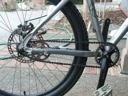

Velo, I remember you telling me about the ghost gear set up but couldn't quite picture it. That does sound really cool though.
Weird but somehow pleasing...
I've seen pictures of bigger chainrings used too (this isn't my bike)
found this

Beep Beep's picture of the ghost gear is exactly as I describe.
Another point is it can be used with fixed gear in a vertical dropout frame, the only tensioning method that does not involve an excentric hub or BB in non horizontal dropout /track end frames.
