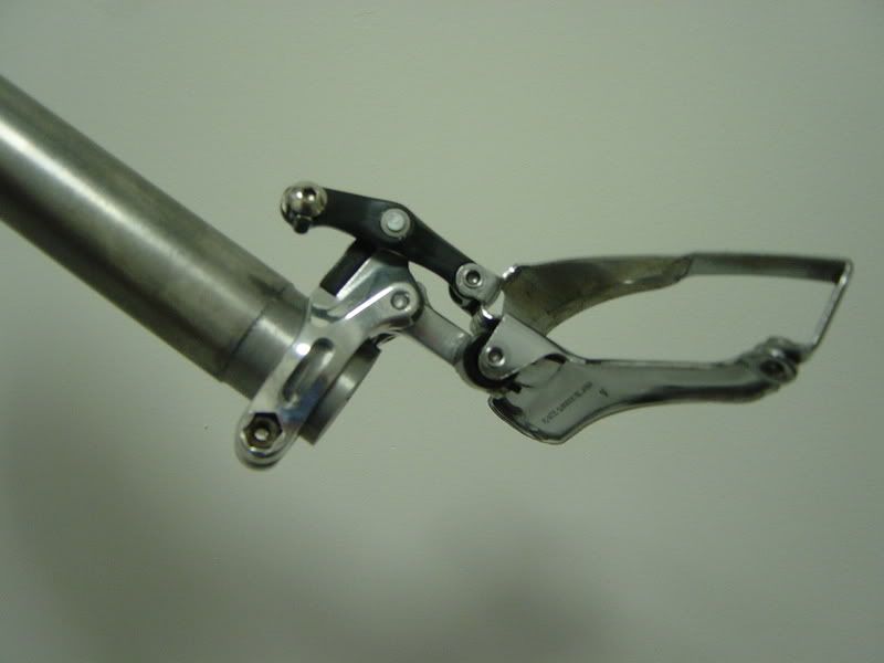

Ok, i think, reading all this, the M735 should have the tension screw, but that there were a few left-overs from the 732, that were badged as: 735.
1990 M735 doesn't mention the spring tension adjuster.
1992 M735 does mention the spring tension adjuster as a feature.
1993 M735 also does.
I've not check the other catalogues as well the 1991 isn't near me, don't think it was as detailed.
Dates Code (the adjuster is Nov 1992 I think, looks like a Q not an O)
Quite interesting and had never really noticed before.
I have two with it the spring tension adjuster cam, MH and PF are the datecodes, if that helps at all

I only know for certain, as not so long ago this 'what it for' came up. The Instructions are in the archive now as well,its also on later mechs.
MH = Aug 1998 that's before M735... (this wasn't a sticker on it ?)
PF = June 1991
PF = June 1991
Gah! The MH is a 732 I gave the wrong code
The other 735 is SF - with adjuster
I wonder what the other guys without adjusters on 735s have?
Mine says CH.
