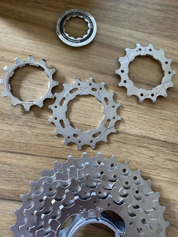

I’ve got two cassettes Pete.
One has PH, PE, PF, PI. Same year but different months.
I also have a NOS boxed one but rings are stamped QR, QR WJ, XF which suggests that the two smallest cogs are later replacements. 😕. Wish I hadn’t looked now.

Your set with PH, PE, PF, PI would stack up with mine then (apart from one which was a from the previous year), as I’d expect Shimano built up a stock of cogs over the preceding months from which to assemble cassettes as needed. Unlikely they made the effort to ensure or cogs were exactly the same age.
As for the NOS set with WJ & XF cogs…that would suggest they are from ‘98 & ‘99 if the build date sequence continues, which seems way off for M900. Could those cogs be from M950/1/2/3 cassettes? Are they even the same colour/style?
Exactly my thoughts mate. I imagine there are giant bins of them and Japanese children under 10 assembling cassettes for $2 a week and shipping them to the UK.
I think my lock ring is correct but more than likely the last two rings are donated from a 737 cassette which would have the right sizes. Not the best find on my NOS boxed M900 cassette I paid for but an occupational hazard I guess. At least they are new.
They would be silver it they are 737.. But dates too late.
Could be grabbed from a nine speed setup with the similar finish. Check widths though..

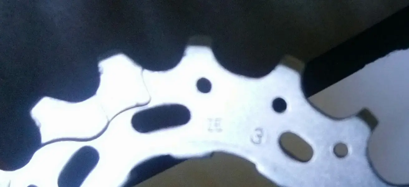

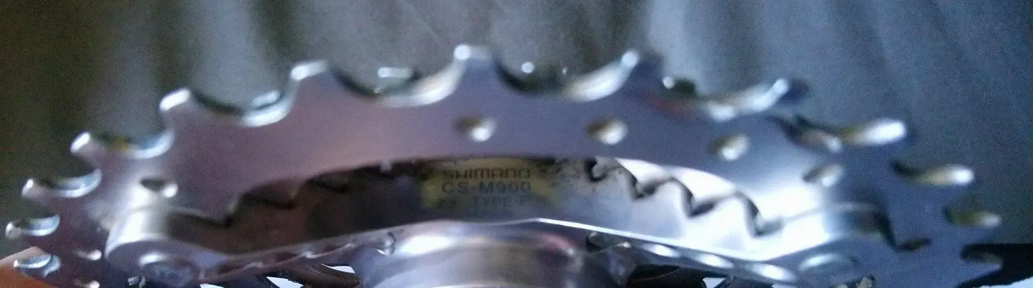

Finding this interesting regarding cassettes, as there is one sitting on the side I thought I'd have a look. 12-32 type P, fully riveted so later. Has codes between YI-ZE which puts it much later, September 2000 to May 2001.
This was boxed NOS when I bought it, very surprising that it's so late! _20220522_105147.JPG _20220522_105122.JPG _20220522_105019.JPG
Crikey Benjabbi. That makes me feel better about mine. Having the same issue. 😀😀
Wonder whether it was a later run to get rid of surplus stock. Date codes are usually bang on.
