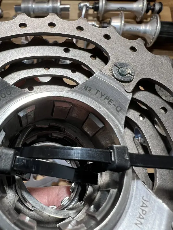

I think the Q3 is the model variant.

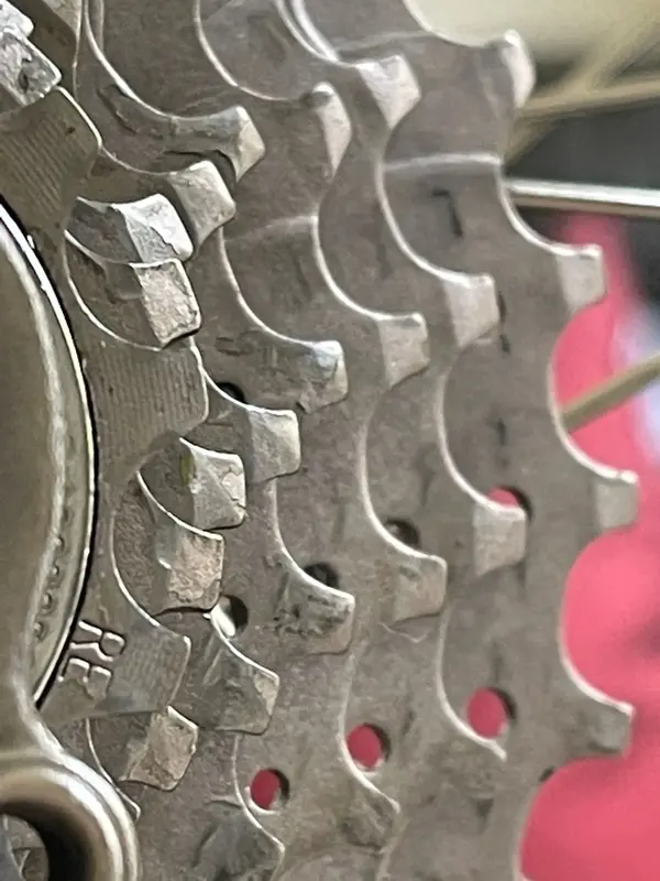

The date stamp should be on the front of the cogs Pete like the picture.
Yep found all of them - they vary for each cog.
Haven’t looked at the front body of the spider, just the rear where there is a Q3 code.
Seems your cassette is mismatched sprockets exactly the same as my type q cassette. Or was this how they were released?
I’m gonna have to go a find and check another now! I suppose the only way to know if the cogs were mismatched would be to check a NOS boxed one, which I don’t have.
