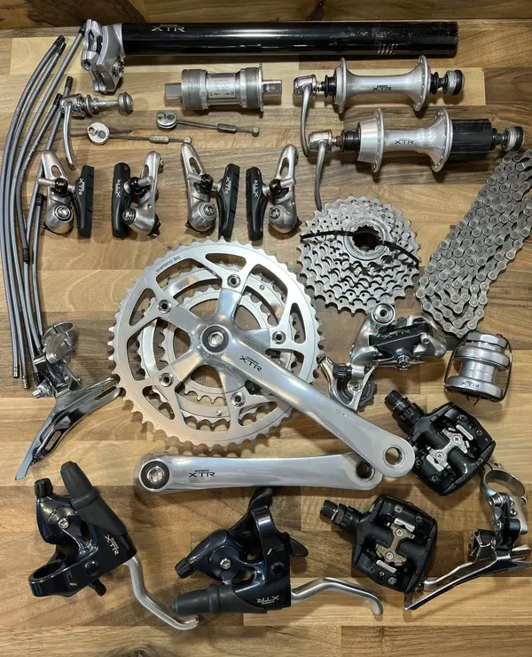

I have a box containing a complete M900 XTR groupset, and for the hell of it I thought I’d see what the build date codes on each part were, to see how many years it covers, and it looks like I have parts from ‘91 through to ‘94.

I’ll do a detailed list of the parts and build dates.

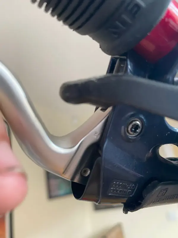

Date codes for the shifters are at the top of the brake lever. You have to pull them as it’s by where the cable attaches.

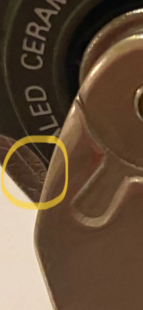

Rear Derailleurs are usually on the inside of the jockey cage by the guide wheel.

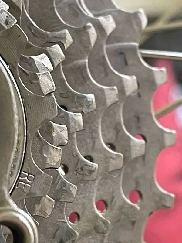

Type Q cassette is 32t. The date code should be on the cogs themselves.

Ill take those dust covers off your shifters Pete. 😉
