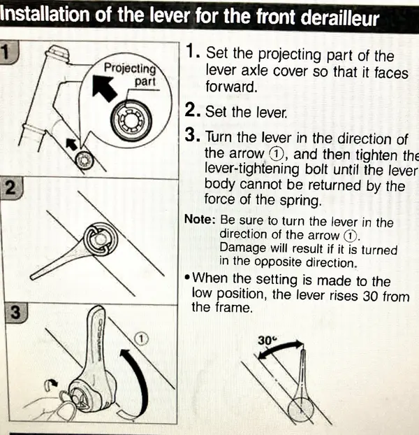

I think @hamster may very well be right. It’s definitely worth trying this first. There’s really very little to break with such a simple shifter, and it does seem more likely it’s just mounted wrong.
Thanks Hammy
Will give it a go tomorrow.

@hamster glad someone brought that up. I was getting ready to ask if the unit had been refit or not since I kbew it could be mis-mounted.

Thanks Hamster and everyone else...quite possibly for the first time ever rather than breaking something I've fixed it!!! I'm on a role and in shock...😁. It was because I had put the projecting part as shown in that very helpful diagram in the wrong direction. Tuh...simples 😁
