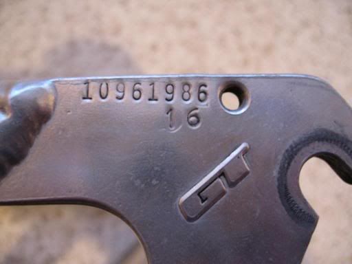

Genuine Q - is not the frame number definitive? A number of sources suggest that first four digits give the year/month. If so, then an "S" and an "E" are presumably "wrong"?

And this is what the serial number looks like

I'll have to check the rear hanger numbers as the one's supplied are from the under the bottom bracket.

i feel like i'm adding to the feeling of ganging up on you, and i don't mean to, i used to sell gt bikes back in the day, the gt logo on the downtube reminds me of a 97ish backwoods, which were if i remember correctly the first year model without the canti mount around the seat tube.
the very obvious way to detect whether this is a zaskar, regardless of year model is to check the rear drop out for "7005" or "6061", theses are the tubing grades and are marked on the inside(?) i think of one of the drop outs. if it has 6061 on it. it is very likely it is a zaskar but otherwise then it isn't.

My Zaskar is a 1996 produced in October i.e. 1096198616. There are no serial numbers on the BB Shell. The Bikes of this era with BB sited Serial No's are the like of the Pantera and Backwoods.
The Zaskar will also have 6061 stamped on the dropout, just like this on mine
