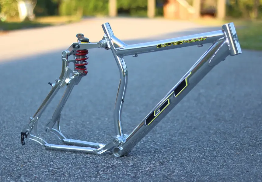

About four years ago I found a GT LTS DH frame from Germany and it was sitting a long time in my workshop waiting for the right kind of inspiration on how I should build it up. For me the 1st gen 'boomerang LTS DHs with the single seat tube curve , and these 2nd gen ones with the 'double curve' have always been one of the icons of 90's DH. And since seeing the first ball burnished Zaskars in the 90's I've been a big fan of that particular finish.
This frame was a little dull when I got it, but it was without any cracks or major scratches, so it had a solid foundation to build on. Someone had also installed a ball bearing upgrade set on the linkages to replace the original bushings which was a nice bonus. It had though the shorter stroke RS Super Deluxe shock on it (1.4") instead of the original one (1.65"), but as you could get about 145mm of rear travel with the original ones, it still was able to get almost 125mm with the shorter stroke shock. This was actually a bonus also as it allowed getting slacker angles for it (and there was issues back then with the longer stroke shock hitting the seat when fully compressed as it was longer).
The first thing I did to it was take it apart and polish the ball burnished finish on it, and replace the worn/missing decals. At this point I still had no idea what kind of build I'd like to turn it into!
![358618444_10159917958913821_3612391118557563722_n.jpg 358618444_10159917958913821_3612391118557563722_n.jpg](https://www.retrobike.co.uk/data/attachments/690/690227-fc55468b1ccdfef40aea53618bcf761b.jpg)

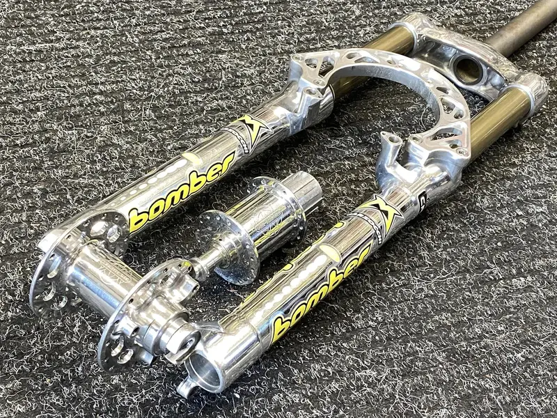

With a frame as nice looking as these it's always really difficult to make a build that can match the frame itself
![Grinning face with sweat :sweat_smile: 😅](https://cdn.jsdelivr.net/joypixels/assets/8.0/png/unicode/64/1f605.png)
![360130664_10159936319143821_4156800658680418897_n.jpg 360130664_10159936319143821_4156800658680418897_n.jpg](https://www.retrobike.co.uk/data/attachments/690/690228-4909b338f3f9dc86e40eed0b91b65cae.jpg)

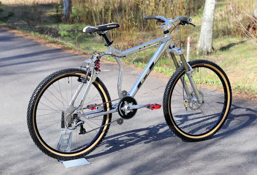

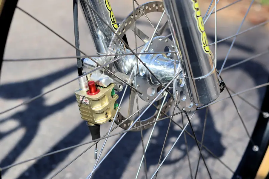

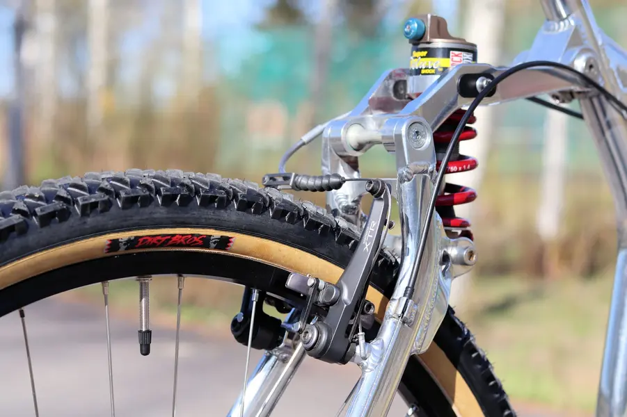

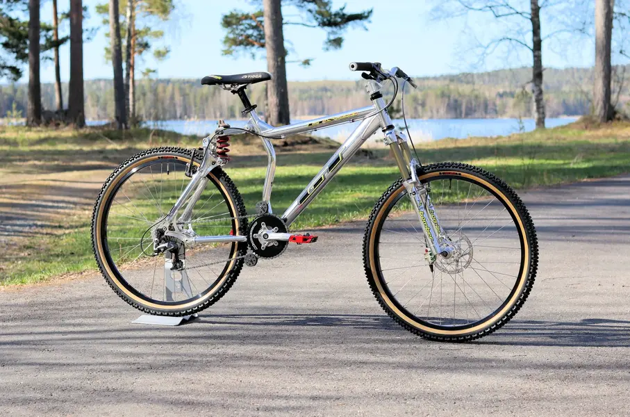

![436306604_10160421523468821_8661442825720122368_n.jpg 436306604_10160421523468821_8661442825720122368_n.jpg](https://www.retrobike.co.uk/data/attachments/690/690237-54d9cd0b1f4fd6a705208634668e2d2f.jpg)
![436455494_10160421508903821_859753252112786465_n.jpg 436455494_10160421508903821_859753252112786465_n.jpg](https://www.retrobike.co.uk/data/attachments/690/690238-fc9837f9667bac46c4212d0b00cf310b.jpg)
![436223913_10160421508993821_3666350017907756896_n.jpg 436223913_10160421508993821_3666350017907756896_n.jpg](https://www.retrobike.co.uk/data/attachments/690/690239-a7fdf95a20e9535115bb9b395fc876c4.jpg)
![436315593_10160421508763821_4104053005045578961_n.jpg 436315593_10160421508763821_4104053005045578961_n.jpg](https://www.retrobike.co.uk/data/attachments/690/690240-0b2b5e277875ec1f593b8f1d62a94c2a.jpg)
![428350840_10160421508613821_3141007885404277191_n.jpg 428350840_10160421508613821_3141007885404277191_n.jpg](https://www.retrobike.co.uk/data/attachments/690/690241-a1c41d2e49cf343f7c64237524c36b95.jpg)
![443818302_10160421508733821_2240804423961106052_n.jpg 443818302_10160421508733821_2240804423961106052_n.jpg](https://www.retrobike.co.uk/data/attachments/690/690243-b66f9250b724bc8139b447c569170620.jpg)
![443839409_10160421509283821_3146603811831583714_n.jpg 443839409_10160421509283821_3146603811831583714_n.jpg](https://www.retrobike.co.uk/data/attachments/690/690244-333895278d29c22e18afbb560d63a895.jpg)
![436313016_10160421509248821_7865969969624891776_n.jpg 436313016_10160421509248821_7865969969624891776_n.jpg](https://www.retrobike.co.uk/data/attachments/690/690245-dce9e0d35f73ed889a7913cafa8aa881.jpg)
