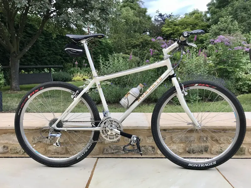

It has been 11 years since I posted a thread about my Roberts DogsBolx. The picture links have disappeared a long time ago so I thought I would create a new post with relevant updates. Back then I never entered it in the BOTM but will this time.

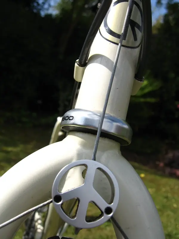

Custom frame, handlebar stem, front cable hanger, headset bearings and the lightest front fork available. They supplied Tange Superlights. White Pearlescent paint with Gold Clarendon graphics.
It was assembled by me in July 1994. It still has all of it’s original components (except inner brake and derailleur cables and NoS grey Specialized Umma Gumma More Exreme / S tyres as the originals have rotted away!). It was designed to be very light and as durable as possible. All the component steel nuts, bolts, spindles where possible were replaced by SRP Titanium equivalent throughout the bike. All the bearings (including the headrace) are cartridge type including the jokey wheels bearings.
1994 Chas Roberts 17.5” Dogs Bolx - built by Winston Vaz in June 1994.

Custom made handlebar Stem ordered with the frame. Colour matched.
Headset mounted front brake cable hanger, (ordered with the frame), sprayed to match frame colour)
Headset: Shimano Ultegra 600 HP-6500. Sealed cassette bearings

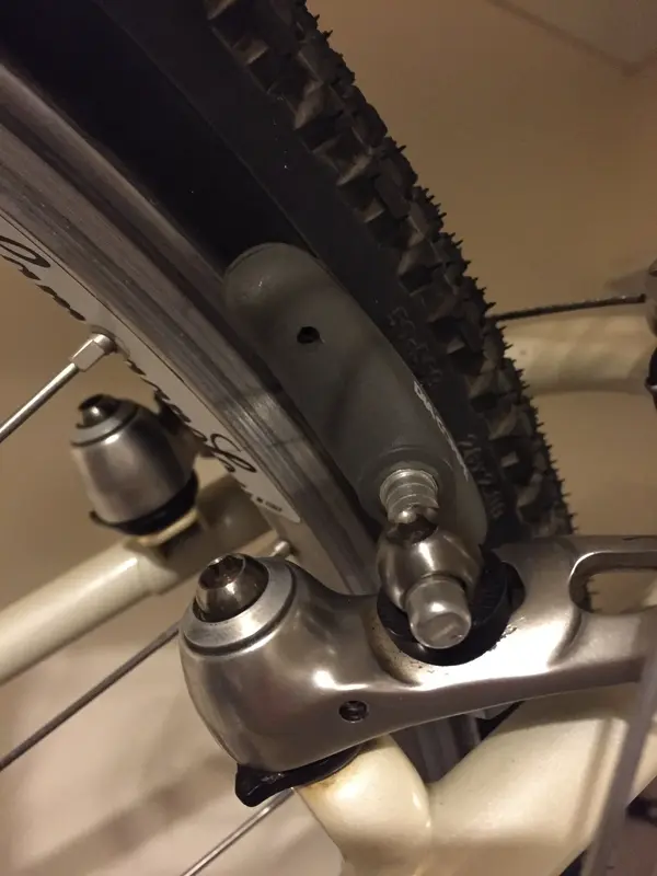

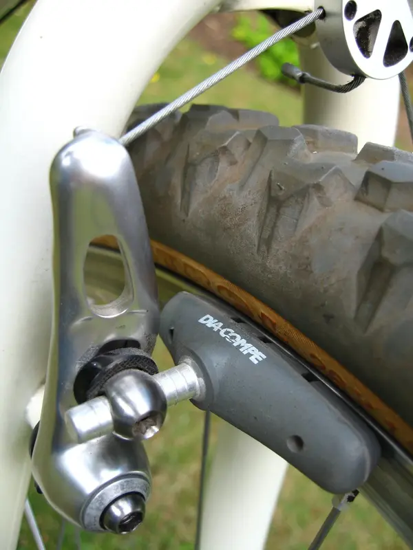

Brakes F/R: Shimano XTR BR-M900
Brake Pads: Dia Compe grey
Brake Cables: Shimano XTR Grey (1994) with Middleburn cable oilers.
Cantilever cable hangers: Ringle Mojo silver

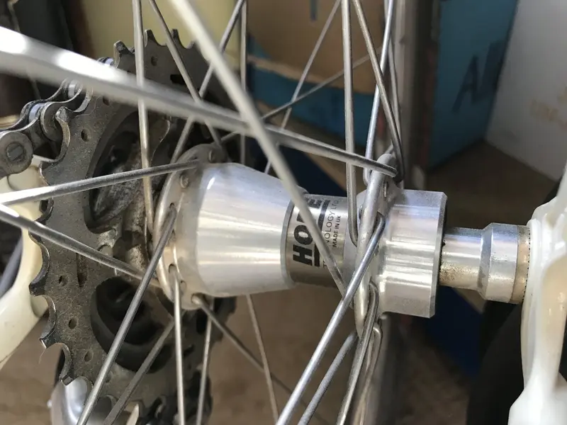

Hubs: Hope Ti Glide Titanium 32 hole
Rims: Campagnola Atek 6082 alloy T6 (32 hole)
Spokes: DT Swiss Double butted stainless steel
Spoke nipples: DT Swiss light alloy
Hub Skewers: Zero titanium

Weight: 21.5lb - 9.77kg ready to ride246C5633-7A41-451B-BE91-BDADA1C36DC8.jpeg2A51FF15-C965-4ED3-B3EB-BCF6B66B5889.jpegE4959C6C-10F8-44D9-AF5A-0FD84DC6AEA1.jpegD3E0CD3E-A19F-4AFF-8192-F1291D8A8B3D.jpegEF110C57-4BEB-4D02-8444-1B683564AB5B.jpegDA179A7A-80FC-4DBC-B922-23DB0CE03894.jpegDB2BD943-1838-4A0A-A508-5D4E632E8357.jpegBBD92404-2DB7-422D-B759-1DD6A9E4E100.jpeg137F6E9A-3AEE-4434-99D6-7E92E3F977FC.jpegB3C5456D-EAF6-40C0-9922-4DD8E83C163D.jpeg
