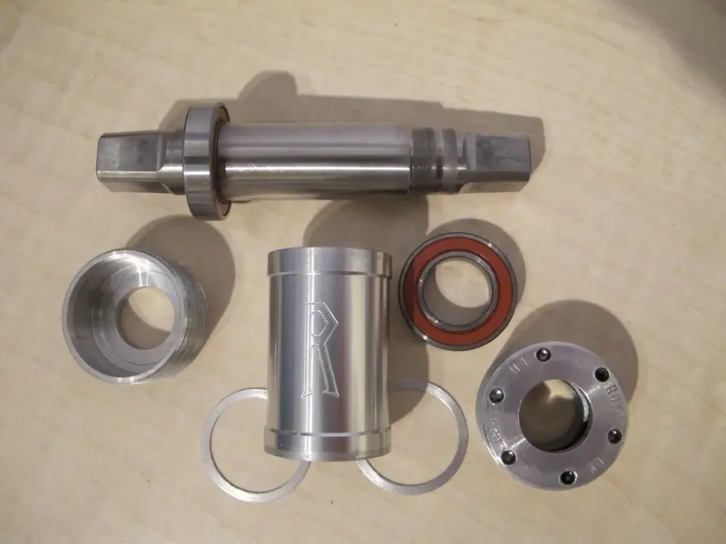

This is the original Royce Bottom Bracket. These last forever and are amazing pieces of kit. Mine failed due to my own stupidity and it was nothing to do with the quality of the components. I failed to follow the installation instructions and did not use loctite on the cups so they kept coming loose which in turn caused one bearing to damage the spindle. I replaced the whole unit and followed the instructions to the letter and I even used the Royce special tools to install it. It has given perfect service ever since.

So many bikes would come in needing replacement wheels, bottom brackets and headsets because the bearings were trashed or had seized cables due to owners lack of maintenance or jetwashing the bikes and flushing out the grease. I decided to build a bike with cartridge bearings so they could be replaced without buying complete new units such as wheel hubs or headsets. So the wheels, bottom bracket and headset all have sealed cartridge bearings. I installed Middleburn cable oilers to keep braking and gearchanging nice and smooth.

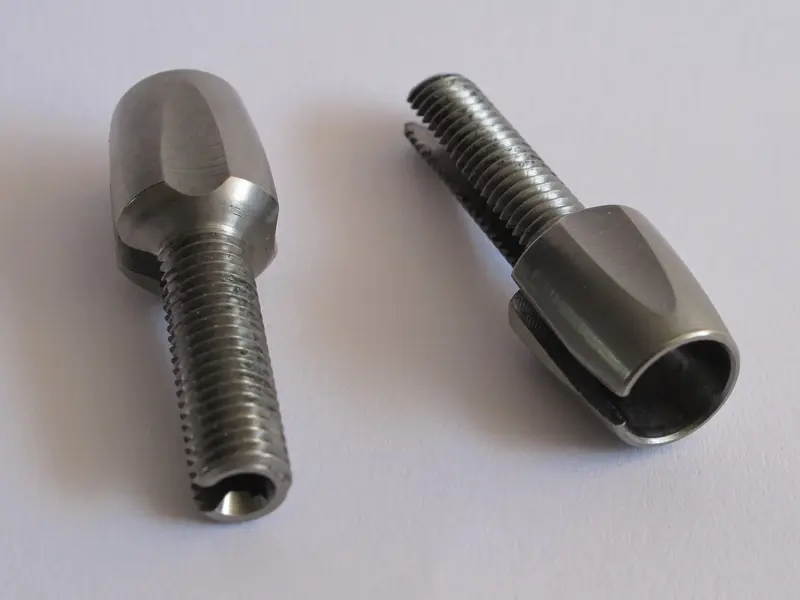

The late 1980s was a time of innovation and new small startup companies selling upgraded high quality parts. Working at the cycle shop brought me into contact with local enthusiasts and companies offering exotic parts. Venhill was a local company making automotive brake lines and they branched out to include cycle components including the titanium chainring bolt set used on my bike. A guy I met Declan Hicks (thanks gtturbo for reminding me of his name) who had started a company calledZero components from his house near Cranleigh and he designed and commissioned an engineering company to make the titanium quick release skewers. He would come into the shop often to talk to Graham and show us his new designs. I remember visiting him at home one night to buy a set of the skewers.

The late 1980s was a time of innovation and new small startup companies selling upgraded high quality parts. Working at the cycle shop brought me into contact with local enthusiasts and companies offering exotic parts. Venhill was a local company making automotive brake lines and they branched out to include cycle components including the titanium chainring bolt set used on my bike. I guy I met (sadly I forget his name) started a company call Zero components from his house Cranleigh and he designed and commissioned an engineering company to make the titanium quick release skewers. He would come into the shop often to talk to Graham and show his new designs. I remember visiting him at home one night to buy a set of the skewers.

The guy from Zero was Declan Hicks. I used to ride with the Motosport lot around 1990/91 so we may well have met. I forget most of the names but there was of course the infamous James Tatlow. Good choice of colour on the Renault Pearl white. Funnily enough I still have one in that exact colour, owned it since about 1996.
