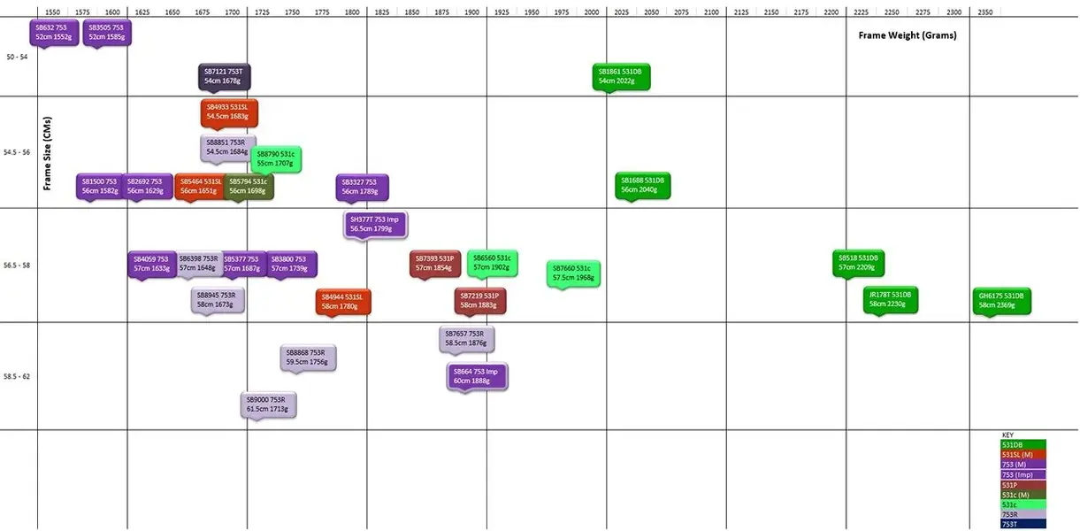

Trying to pinpoint tube type based on frame weight and seat tube length is tough. Here is an image of a few of my SBDU frames and their weights (frame only), you can see that weights are all over the place...
If you look at the region of approx 1700g I have frame sizes from 54 to 61 cm in 5 different tube types...
