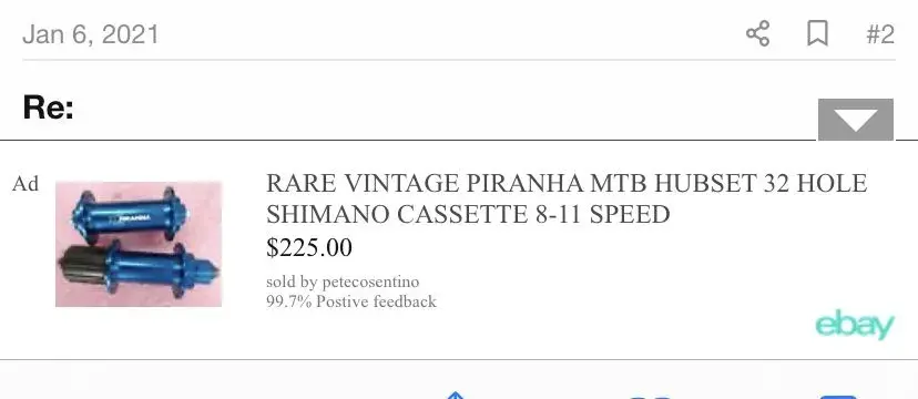

Rear hub. There was an old listing here that said the original cassette was a shimano 8 speed. Anyone notice any problems if that cassette is used?

Through the magic of the internet, the old listing thumbnail was saved here. Link is long gone

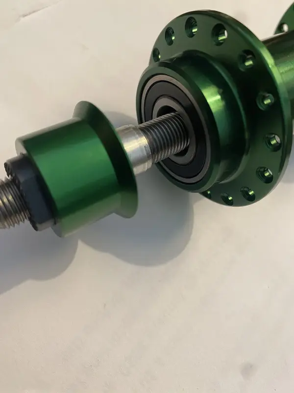

I stink at photos…. But anyhow have worst luck my entire life getting colored nipples. Bike stores hate them etc etc… order enough to make four wheels shipping takes a month and when they show up bags is ripped with 40 nipples inside. So just front is done
