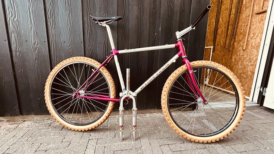

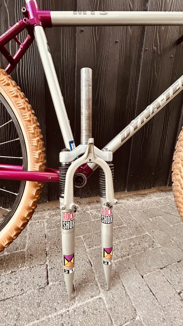

Took it apart today and gave it a good clean. LX shifters are toast despite they look cosmetic in good condition, shifts are numb. Will try to clean them and get them back to working condition.

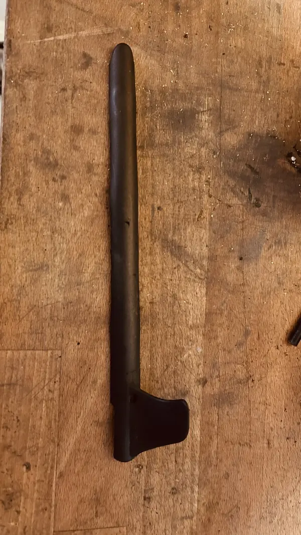

Seatpost was cut down to some 20 cm, stem 1 inch was fixed with a bushing to fit the 1.8 fork, not really secure 🤨
Removed all components, cable guide under bottom bracket fell of and someone tried to pinch a screw through the bottom bracket shell 😳. Some mechanics...
Overall frame is in good condition, decals are apart from some small nicks still OK.
Fork has most marks but I found my old Mag21 is nearly same colour so as grey tubes, slightly more yellow. What do you think about adding this here?
Wheels replaced with some XT /Ambrosio and butterscotch Tioga's, another seatpost with Vetta seat, non branded stem and True Temper bar.

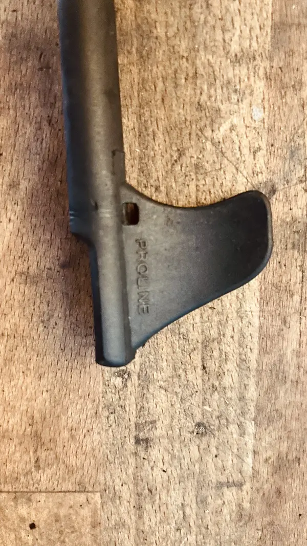

Question for the "sharkfin": this came with this frame but is a Proline. Material is softer compared to the XT fin and slightly different shape. Is this original? Don't see this in any folder.

Sharkfin: In a nutshell - no! Screenshot_20250425_203337_Firefox.webp
