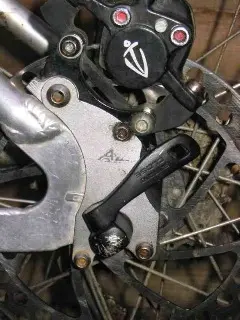

that last one, what kind of hight u have on that fork? 100mm's? I'm gonna build up my avalance next week (I hope) with a 100mm's fork and I am a bit worried about the geometri, my friend has the same frame with 80mm's and that works fine but. I'm gonna go for a rigid fork later on but...
What kind of adapter did u use for the disc? I have to ride with my old battered 8 speed, xt wheel for v's until I get around to find something that works for discs...
Its called an A2Z adaptor and bolts around the dropout - around £20 in the UK. Photo shows how it attaches, and it works really well on the flat GT dropouts. BTW, it's a 100mm fork, and maybe it's partly because I'm used to it, but handling seems fine. :)
