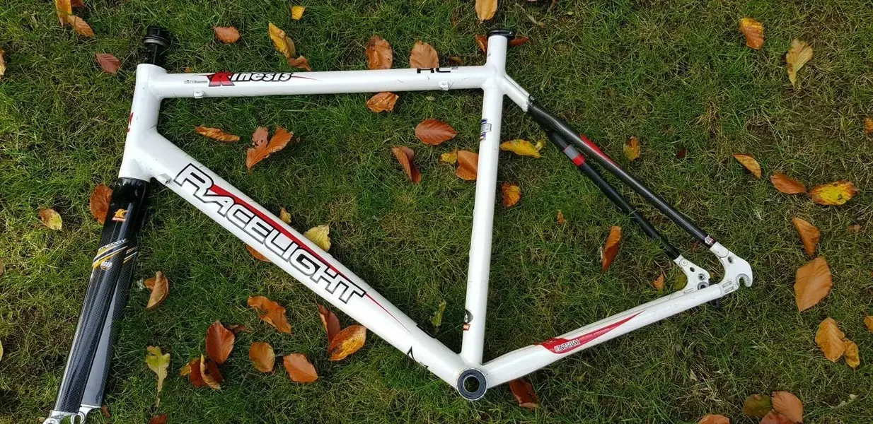

Started with a frame. A Kinesis Racelight RC2 which I picked up locally for £45.

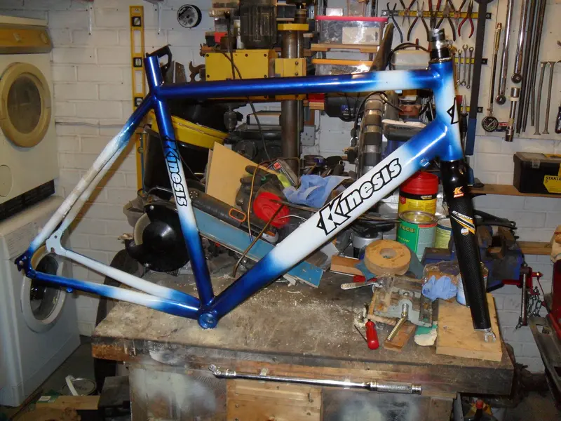

Didn't go a bundle on the decals so decided on a quick rattle-can respray from a can I had in the garage which unfortunately reacted with the existing finish meaning that it had to be stripped back to the base alloy.
Then etch primed - again with paint I already had
followed by a blue fade over white finish with a couple of coats of clear after I had applied some vinyl decals sourced from Ebay. The blue paint I had to buy, the white and clear I already had.

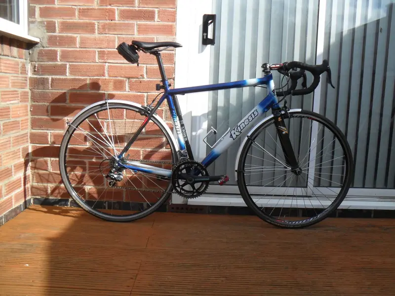

The result:
So how does it ride? Surprisingly well. It rapidly highlighted that the over 20 year old brake blocks on my Colnago weren't up to snuff any more - they seemed ok but compared to the much newer pads their stopping performance was woeful so they got changed.
Set up for winter. I've been able to fit a set of narrow guards albeit with some cutting of them and a bit of modification to brackets as clearances are tight - especially under the fork crown. The Campag pedals have been swapped out for a set of HTI spds so I can wear boots during the cold weather, they'll be changed back when it's warmed enough for me to take riding with overboots again. The HTI/boot combination has turned out to be suitable for utility rides too.
