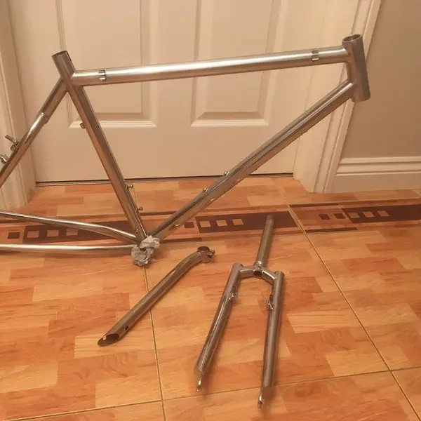

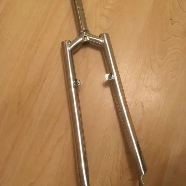

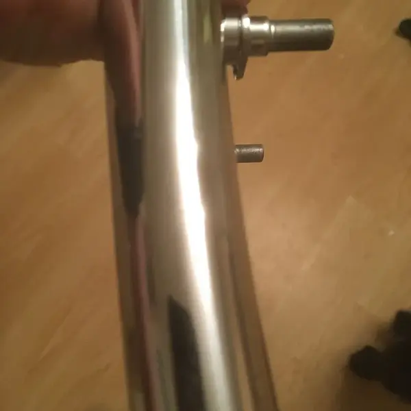

Watch this space... here’s pics of the shiny now de-laquered forks :D

Beauts!
That's how I did mine years back, with stripper and like you say, it's rather easy.
Are you getting it relacquered or are you going to wax/oil/polish it?
I have a P7 that's mostly had all the lacquer removed prior to my ownership. There's some left around the BB etc. I'm trying to decide whether to clearcoat it or not..
Gonna leave it in un laquered but I’ll polish and seal it.
My Sunn Xircuit is naturally un laquered and is fine.
So long as you rinse em down and give them a re polish I recon they’ll last forever. Laquer will only degrade and yellow again over time.
I might have been nervous about not re laquering but the Sunn proves it’s not necessary even from the factory.

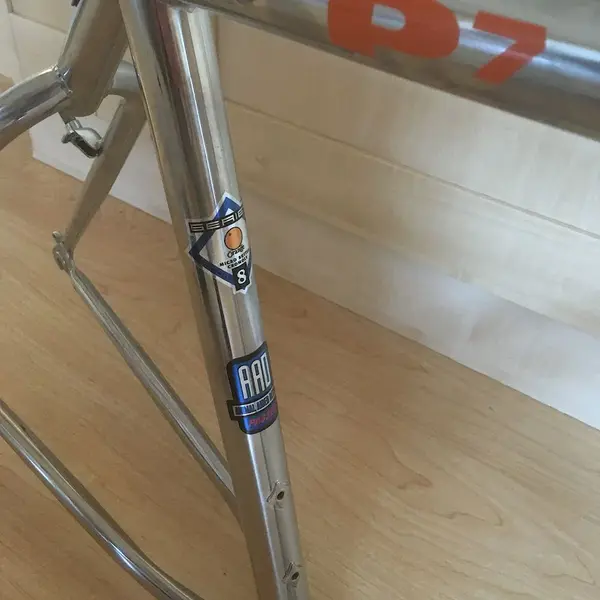

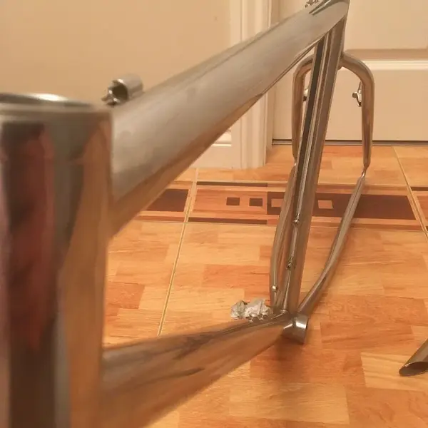

Frame polished with autosol and medium course wire wool after laquer was removed in previous post.
Has come up a treat.. but sore fingers after around 2-3hrs graft to polish frame and forks....
Have rinsed out all the drain holes with wd40 to give it a little inner jujsh if protection...
Will let it rest and dry for the night then a layer of autoglym before decals go on...

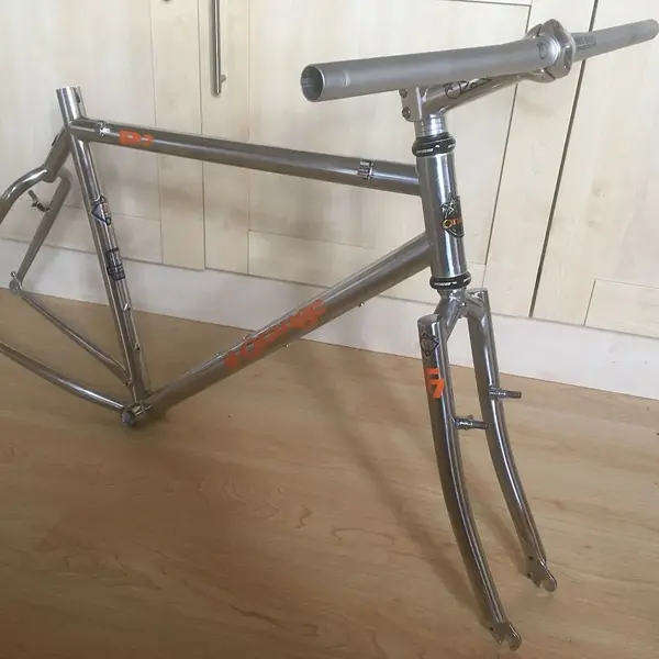

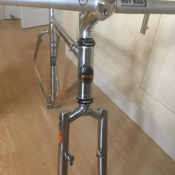

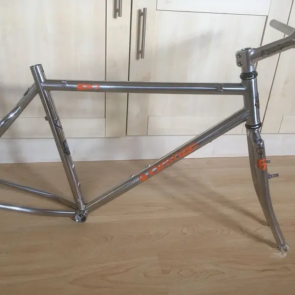

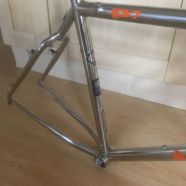

Decals fitted....
Made templates before I stripped it so in exact position as factory.
Thanks Gil M for the top quality repro decals....
It’s on its way to being a bike again!
