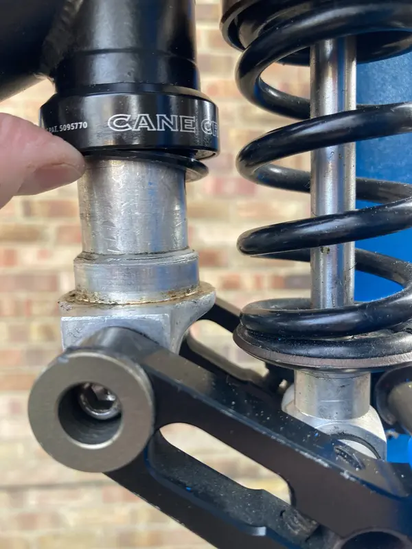

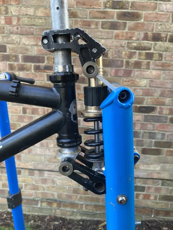

Soooo, I've had a bit of a brainwave.
Rather than have the 1 1/8 bit at the base of the steerer turned down to 1 inch, I've had the thought to use 1 1/8 spacers on it to essentially build it to the width of the crown race. It has a bit of a bevel on it so would likely need to go a bit higher, but the crown race would then sit on the spacer.
One for the weekend, and a rummage through my headset parts.
