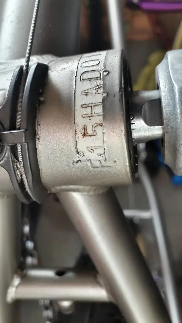

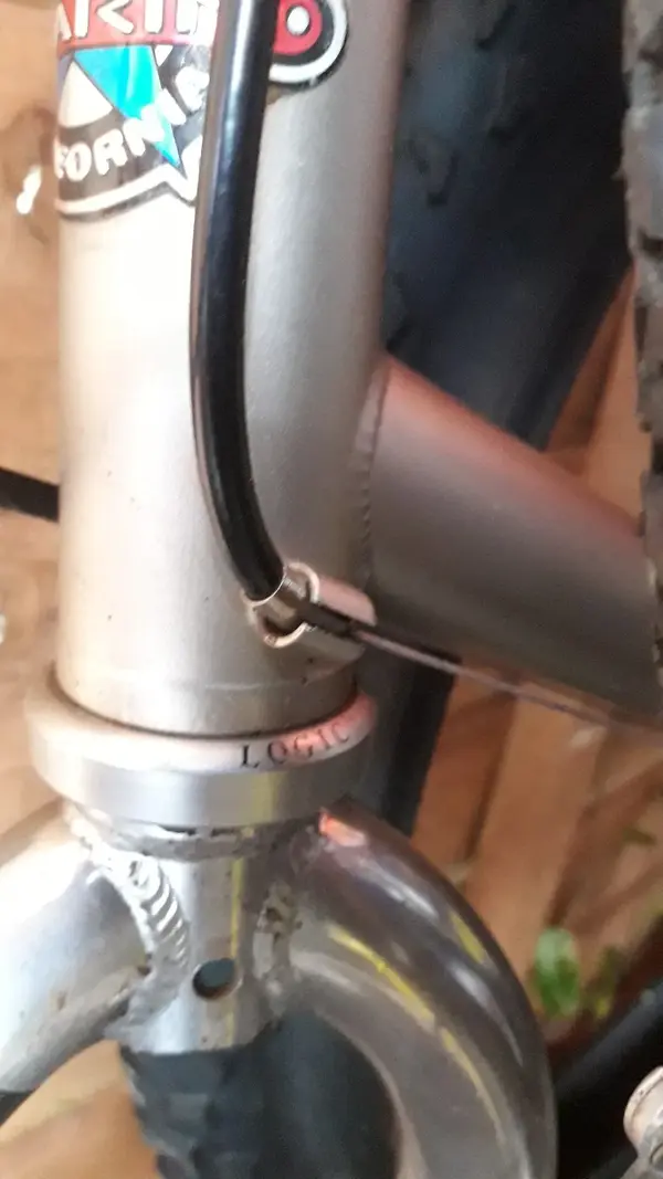

Team marin 1995.
Heres the basics.
Serial number begins F1. For that year, careful now! Headtube stops, 27.2mm seatpost. rack mounts, satin silvery colour. Measured centre to centre.
I own one, can vouch.
Tange ultimate badge not always present on larger frames.
Team issue.
I dont believe there was a catalogue/public model available.
Pine mountain.
I've had one. Didn't take serial number. I'm recalling M2.......
Same silvery finish.
Rack mounts.

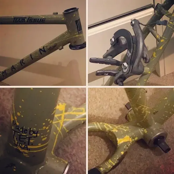

My s/n is 90TM0629E with Tom's TET 15 also on the shell. I've been told that the 15 is the frame size and guessing 90 is the year
Wow. Ok thats a left field one. Ive only ever seen pictures of the teesdale marins. Im not sure they share anything in common with the far east fabrication?
Is it true that they are brazed and lugged in part?
That numbers like nothing else ive seen! Anybody else?
But your assumption seems logical.
I know the early Team Issue's were made in the USA. I've not seen Tom Teesdale's name mentioned in any literature but that's not unusual, as they could then contract out to various different builders if they wanted to, depending on workload/quality. All brazed - this is the only image I could find on my phone and the frame is in storage just now
