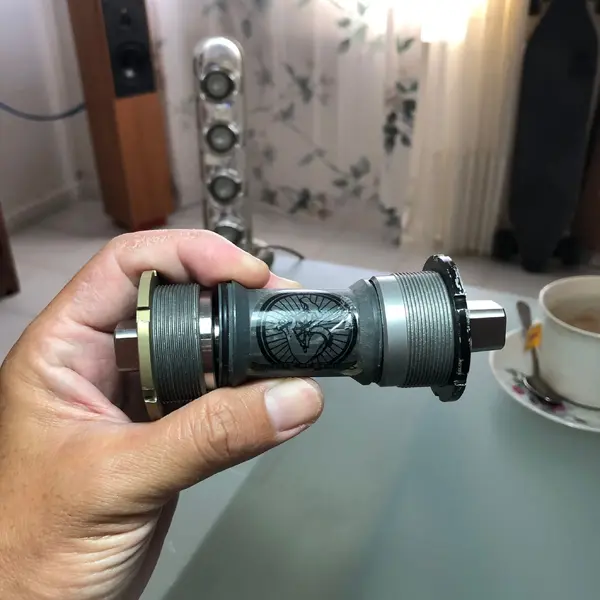

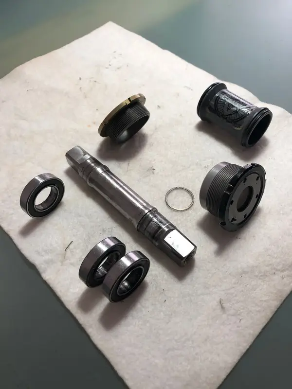

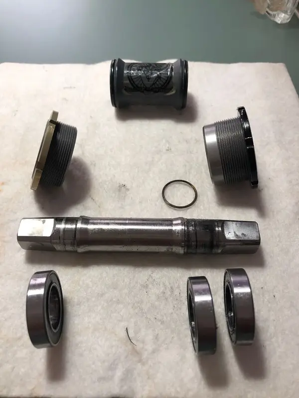

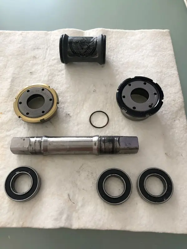

Anyone experienced before with the SYNCROS Titanium Bottom Bracket can help?
Is mine a 1995or 1996? Certainly it is not the 1997 which had the metal shell.
How many bearings should there be in the bottom bracket?
Because from what I saw from the catalogue there should be just 1 on each side. = 2 pieces.
When I got it dismantle I discover there were 1 on one side....2 on the other side.
Which side is the "Drive Side"?
Appreciate anyone can help.

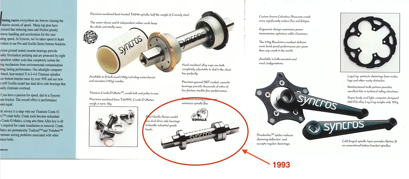

I got some clue here from the 1993 PDF Catalogue.
This could be the 1993 GORILLA Series.

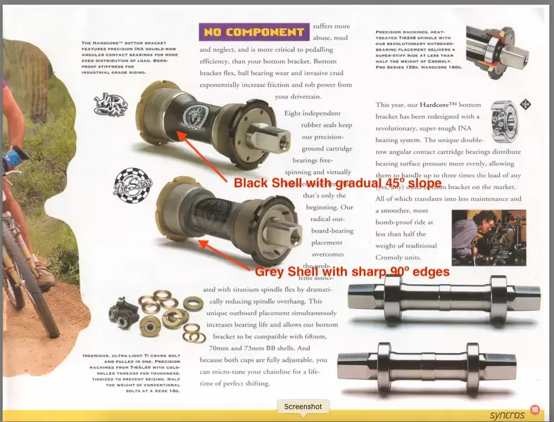

2 bearings on the drive side.
But the shell that I got here belongs to a 1994 & 1995.
In 1994 SYNCROS introduced 2 different bottom bracket design base on the 94 catalogue:
1. Pro Series
2. HARDCORD. (INA Bearing)
Mine Syncros Ti = Grey Shell 45º slope design
