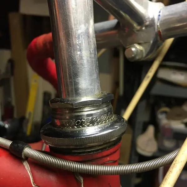

While I will stand corrected, I believe that pictured headset is potentially a mish-mash.

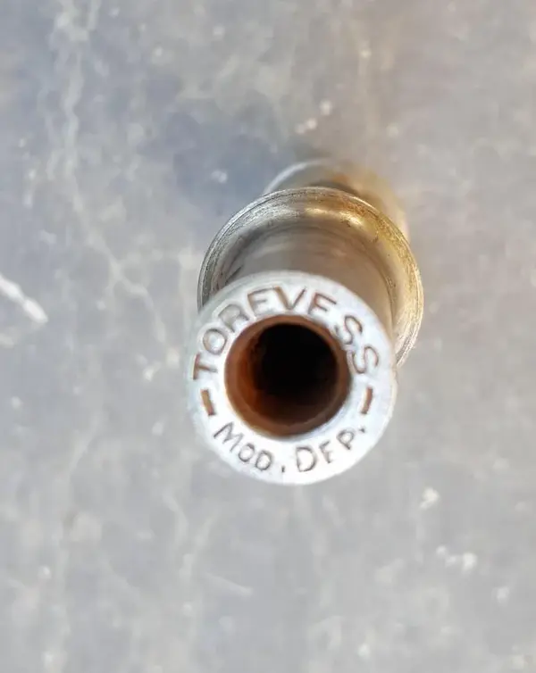

Parts from three headsets, Stronglight for the lock-nut, Torevess for the locking washer, and RFG(?) for the cups.
Understandable too to replace worn bearing surfaces with something French and a low stack height.
Looks like you are correct, definitely a Stronglight lock-nut on that. I hadn't really looked at it and thought it was a Stronglight P3 headset, but then I saw the Torevess print while taking those pictures of the frame.
Every bearing surface is regreased.

P3 brinneling -
you could mark the two pressed in head tube races and their seats with a pen or crayon, remove them and then remount a half ball thickness away
this will reduce the ratcheted feel of the mechanism

P3 brinneling -
