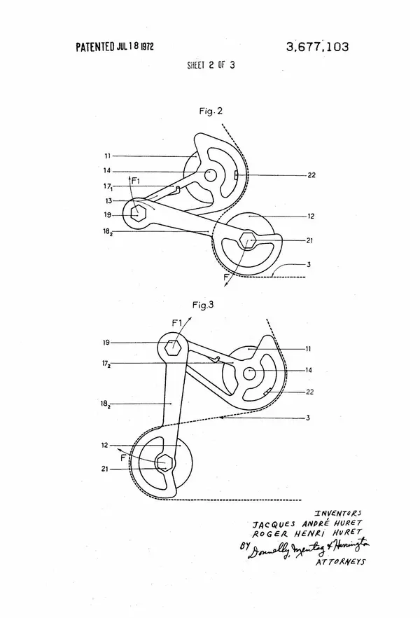

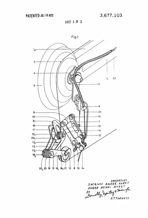

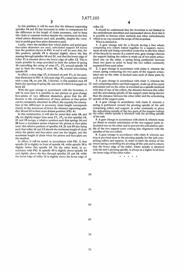

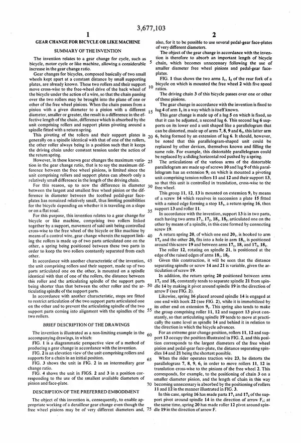

Really!? This one?
"US application filed December 1970, French application filed March 1970"
The patent for Huret Duopar was applied in '73.
Source: https://www.disraeligears.co.uk/site/us_patent_3677103_-_huret.html
us_patent_3677103_-_huret_parallelogram_scan_2_main_image.webp us_patent_3677103_-_huret_parallelogram_scan_3_main_image.webp
Thank you!
Yes, the mech I saw all those years ago looked more like the drawing in the patent record you posted than like the production Duopar with which we are all familiar.
Reassuring to learn me "memory" was not making it up! :D
Shall look forward to seeing Herr 303 whenever he is completed. ;)👍

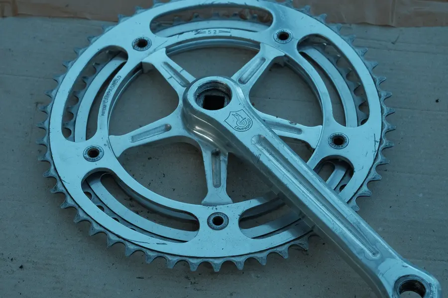

I have another project that's been waiting to have the proper parts that I'll try to finish first.
Here's a few clues.

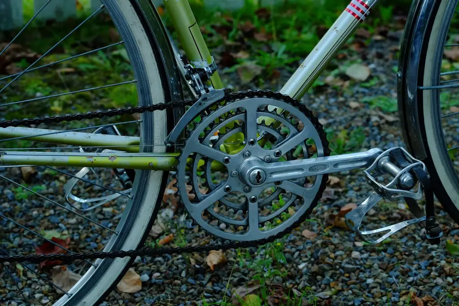

Thanks, it's a bit rough the frame, and the rear fender line is awful.
Getting the right fit is always a challange. I'm about 186cm with 86-87cm inseam and this frame is 57cm c-c? Anyway I lowered the seat post a few cm from what it was in the picture.
The 180deg. lever throw on the FD is too much so I will take the triple TA rings off and put the Stronglight 49d rings that came with the crank back on there. Weirdly both front and rear shift really well. The chain is old Sedis chain that was under 0.75% of wear and the freewheel is Atom with the "S.G.D.G." stamped on, so made before 1968?
Only thing is that because of the toothless lower pulley the chain moves around more and rubs on the pulley cage. I aligned the hanger and chainline is good, but on large-large it starts to make itself heard.

Early 60s, top model. I have not specified the tubing. Sister model had Falck stays and fork.

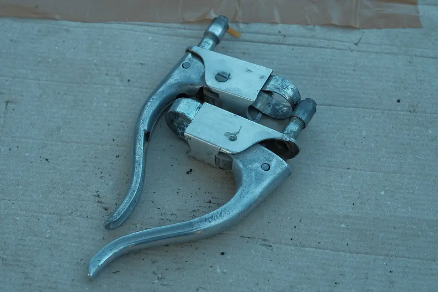

Yes, the correct levers should be mod.61 or pre '68 301/306. Only original parts left on the bike were brake calipers and hangers, headset, FD and maybe the BB cups, but probably not(original most likely "Con Sfere da 3/16").

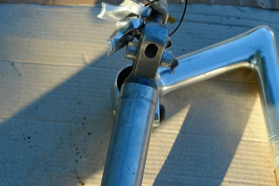

The seatpost is also later. I think the relief from the shaft to the rail assembly on the first iteration of the Record post is almost 90deg. This has more rounded relief and min. insertion mark so it's post '73 post?
Notice how I said, a few posts back, that I don't see value in visual restorations and something about "catalog correct components", well this is "budget component visual" restoration. :LOL:
Half of the levers sold have the old crusty hood covering the screw and the other half are the later ones.
But I found one set of 51 levers with fully open back for sale only for fair price of 200€. Would be great on the Monark...
Hunting for the correct, correct components would equal to better condition "one of these" models.
"Con Sfere da 3/16"
only produced anno domini MCMLXIII
shall require a Record model anterior mech with a housing stop - $$$
Record model stern mech nominally launched December 'lxiii so would be marginally plausible to employ...
Ambrosio Champion stem & bar set
"The 180deg. lever throw on the FD is too much so I will take the triple TA rings off and put the Stronglight 49d rings that came with the crank back on there."
Freres Huret drum size
"Con Sfere da 3/16"
Georg Fischer, BB surfaces have been faced down to 68mm.
I have two of those. The bike came with one.
Record or Gran Sport. Have both, but maybe I'll use the Record as other parts are later 60s.
Have the laurel and shield/knight crest mod. 64 bars with three knurled rings and 1A "Cinelli Milano" stem.
