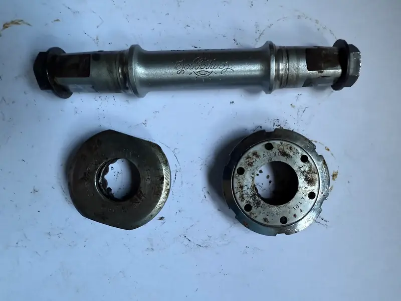

My Latest Project - Early 1970’s Grandini

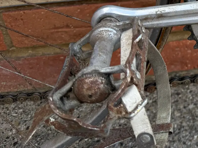

Pedals are Campagnolo Record with the external toe strap loops and chromed steel dust caps. Toe clips and straps are Christophe.
The pedal cages and toe clips are quite rusty. If I scrub them with white vinegar to remove the rust will it leave the remaining chrome behind? I would like to preserve as much of the original finish as possible.

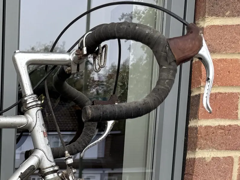

The bars are Cinelli Campione Del Mundo and are 40 cm wide. There are two layers of the original cloth tape wound on to them.

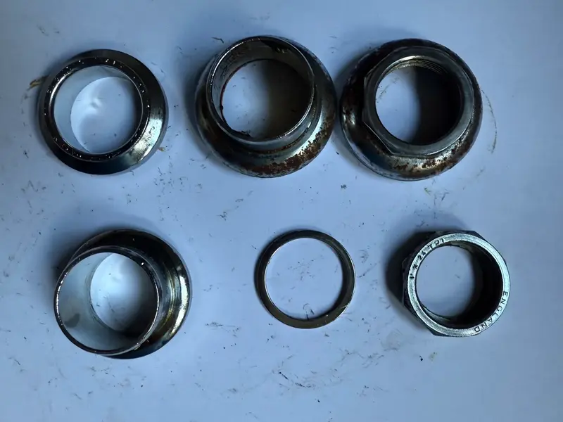

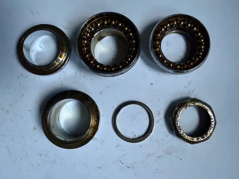

The headset is in remarkable condition. It has a bit of superficial rust on the outside but internally looks perfect.

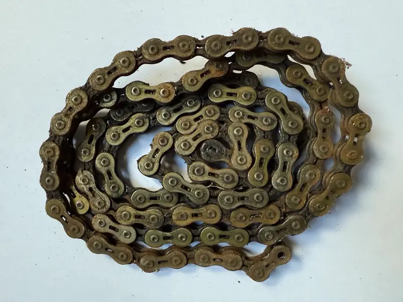

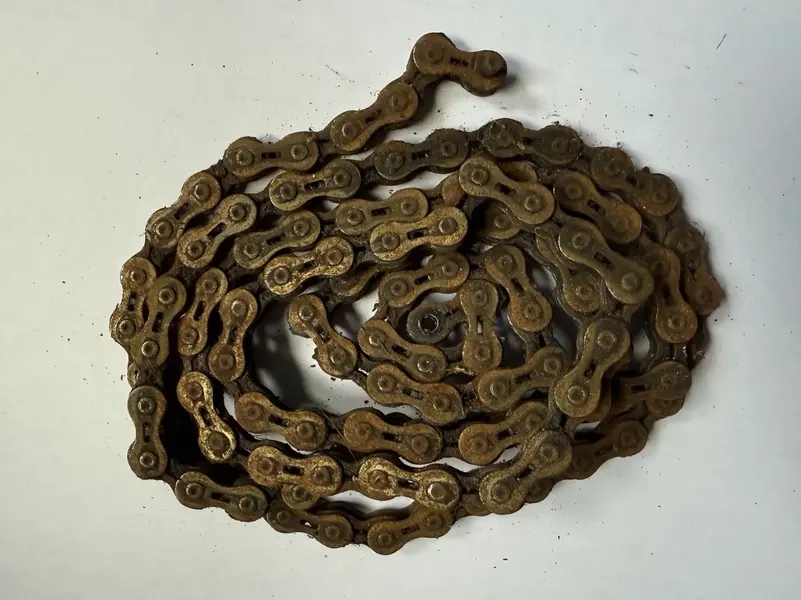

I’ve put my Park Tool CC-4.2 Chain Wear Indicator on the chain and it’s showing absolutely no wear!
I believe the chain is an Everest Serie Special chain with slotted inner and outer links. I’ve just got to give it a thorough clean and get rid of the rust on the outer plates as best as I can.
