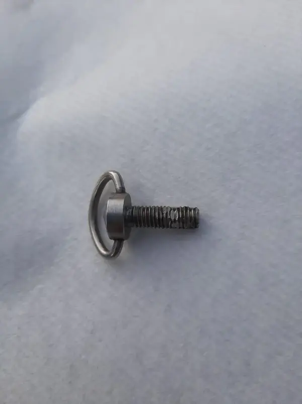

The shifter bolts somehow got to look like this. With a thread die got them to work perfectly fine.

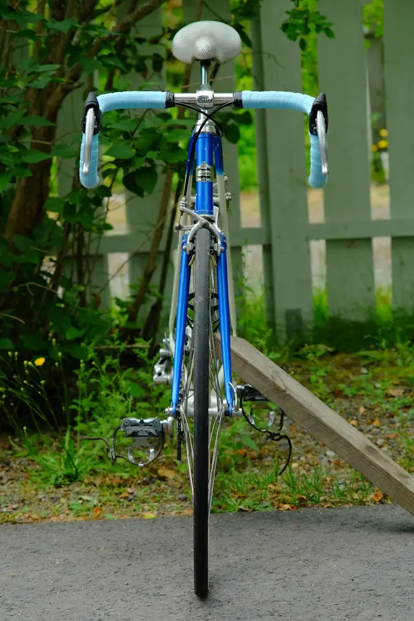

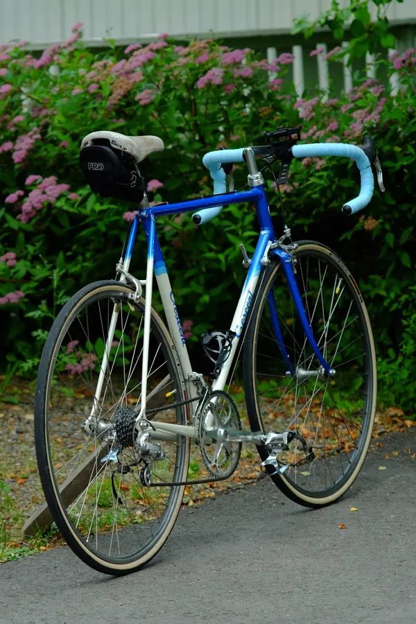

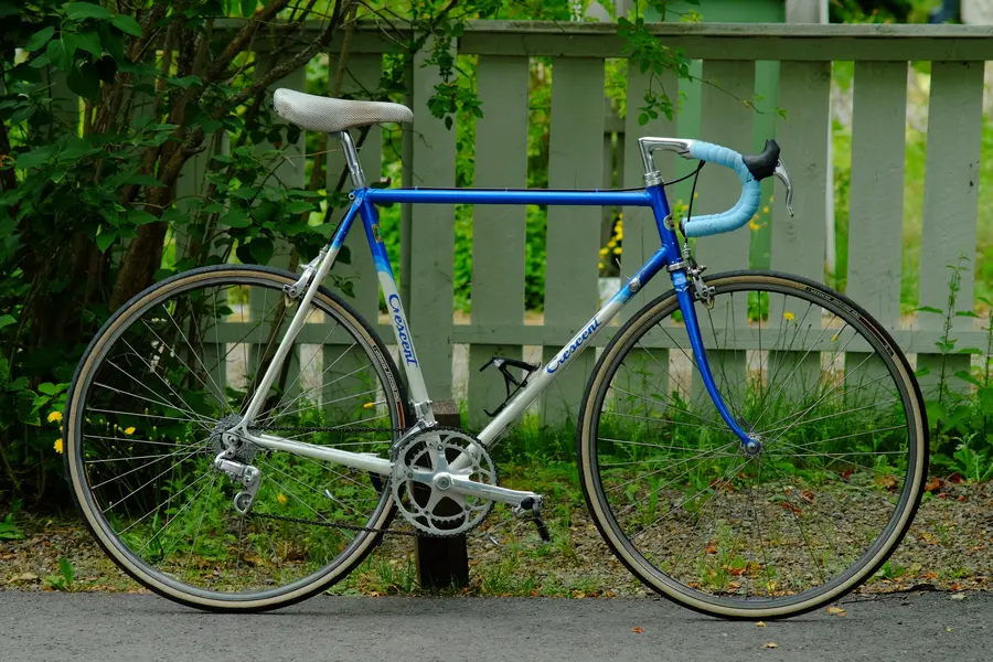

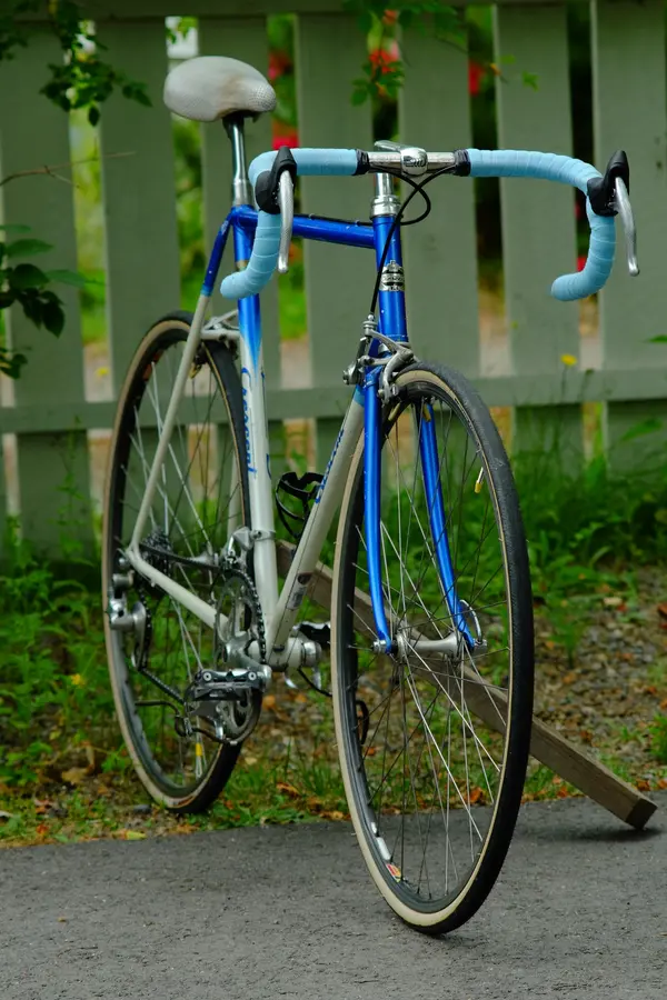

Did about a 30km trip on sunday. Some fine tuning with saddle and seatpost 1cm up and then I did 70km's yesterday.
The saddle is a bit shabby, need to get the colour back(not my a*s/ball sweat, cleaned and conditioned)
The bike feels a bit small (57cm TT and 110mm stem) and I really need to invest on some locking Look what you call them cycling shoes, because I have really wide feet (flat feet, 45/46 size shoes) and my feet go numb with the cages.

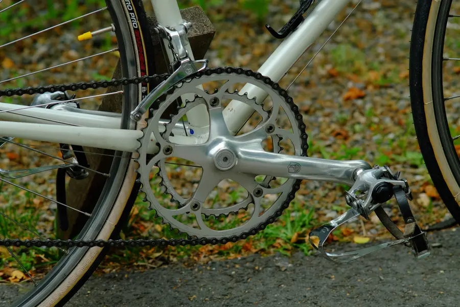

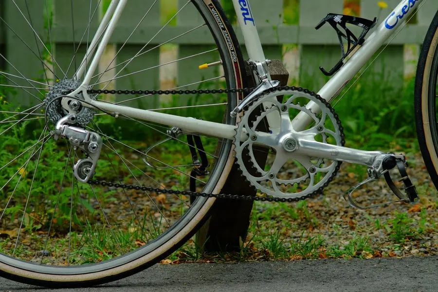

The 1st Chorus is great, shifts really well and brakes feel good. I did get some ghost shifting, but that might be due to the chain being too short or the lever pull/7spd spacing. Also the cage on the FD is little mangled up and started slightly to rub on the crank arm. The spindle is 111mm, correct size for Ita Chorus BB? Could be little wider for the 7spd chainline and better feet position.
Tires are 28mm's and the gears 52t/39t, 13-25t.

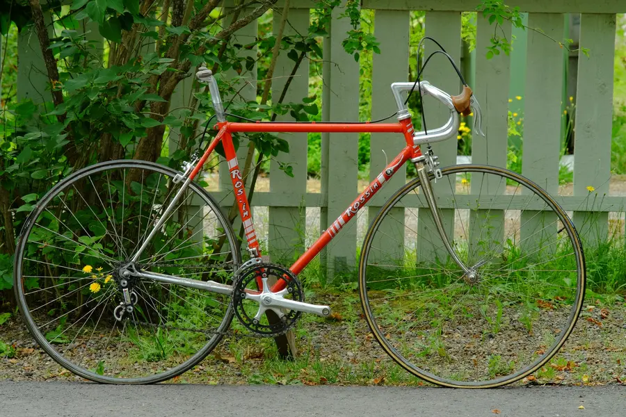

And here's a Rossing Record with Gipiemme Crono Sprint group

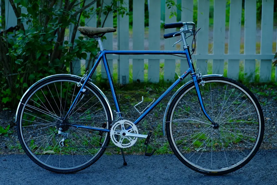

56x56cm Raleigh Touriste. Wheebase is 104cm. Cyclocross or someting like that.

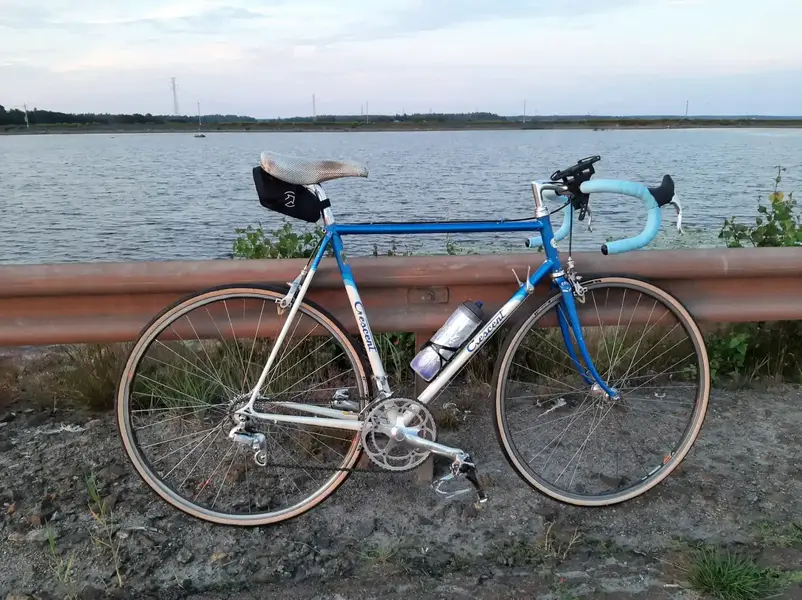

My commuter/grocery getter Crescent, usually with front basket.

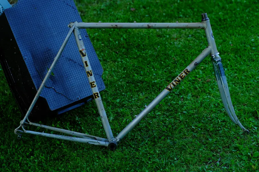

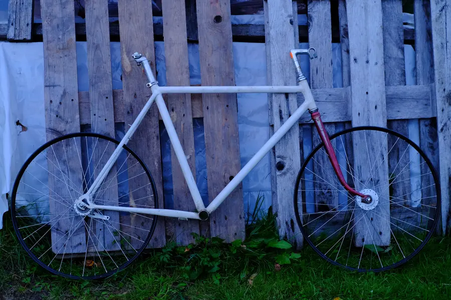

57x57cm Viner Special Course
