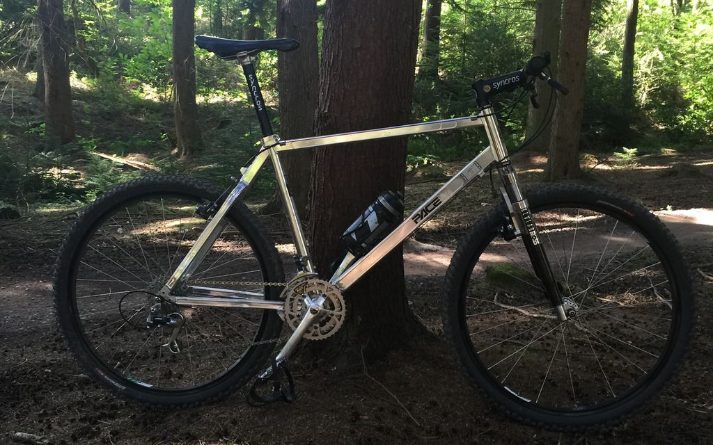

Thanks Wadsy. I'll try and take some better detail shots than the ones I have currently. The build list is as follows
Suntour XC Pro 7/8sp thumbshifters
Suntour XC Pro Multimount brake levers
NOS Suntour XC SE rear brake / XC front brake
NOS Suntour SC Pro MD front mech
Suntour XC Pro MD rear mech
Suntour XC Pro 8sp MD cassette
Suntour XC Pro 175mm cranks
NOS Suntour XC Pro Greaseguard BB
Suntour XC Pro Greaseguard hubs MD specific rear
Suntour SC Pro/XC Comp skewers
Campagnolo Stheno rims
Ritchey Megabite 1.95
KMC 8sp chain though do have an original Suntour chain (just need to source a couple of links)
Blackburn Mountain Cage
Syncros 1" cattleprod ahead
Syncros Bars
Sakae TR 350mm seatpost
Flite Alpes Ti
Rithcey WCS grips
Chris King 1" ahead
Nice 8)
Cheers. Really happy with how it looks and the MD is just great, a lovely chunky and positive change that reminds me a little of the Campagnolo on my road bike in terms of shift quality. Only planned change to the spec would be a Syncros seatpost in black just to make sure collars and cuffs match, otherwise nothing is changing! :D
Really nice clean build, you don't see many XC Pro equipped Paces about so for that I salute you mate!
Cheers for sharing and enjoy your bike 8)
Took the bike for its first ride round my local trail at the weekend. Performed rather well for a 20 year old bike though having not ridden a mountain bike for quite some time, I didn't manage to keep up with my friend on his fully rigid Attitude...
