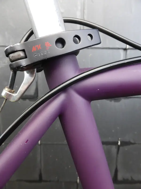

If it can help narrow down the year, rear axle spacing is 130mm, so 80ish. But sloping geometry, rear cantilever brake mounts (i.e. no U-brake mounts) and forward seat pinch are so 90ish. Surprisingly, no rear brake cable stop. At all. And with the forward seat pinch, you cannot attach any removable rear brake cable stop, as on my Peugeot Team Line 2000:
So, I don't know what were the brake options at the time (Magura Hydro Speed Mountain?). Oh, and while we're detailing the rear brake line, did you also noticed the strangely un-evenly spaced cable mounts on the top tube?
