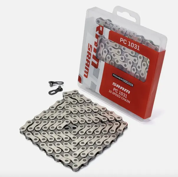

Which one would be good here? -Sram always seemed to have a bit of an edge on similar level Shimano stuff right from the off...
Any difference in width on these -seeing Sram...loads of choice
Get this one -just cut it down to length... Screenshot 2024-07-11 at 20.59.22.webp
