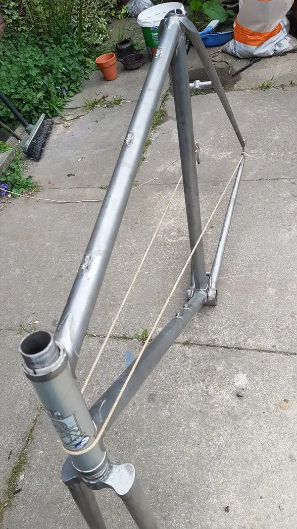

Is there an easy way to check the rear triangle alignment?
20220510_193728.jpg measure from the string to the seat tube on both sides. The measurements should be identical if your frame is in alignment. Use a thinner string than I did though- that's just so it shows up in the photo.

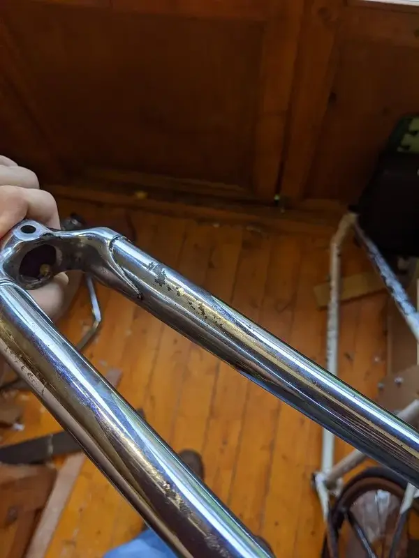

The fork chrome is a bit worn - is there a good solution to cover up the rust spots?
Option 1 is to strip the chrome from the whole bike & get it all powdercoated in one colour, then add second colour highlights myself.
Option 2: Try to salvage the fork & rear triangle chrome, cover up the rust spots and end up with a shiny little retro machine.

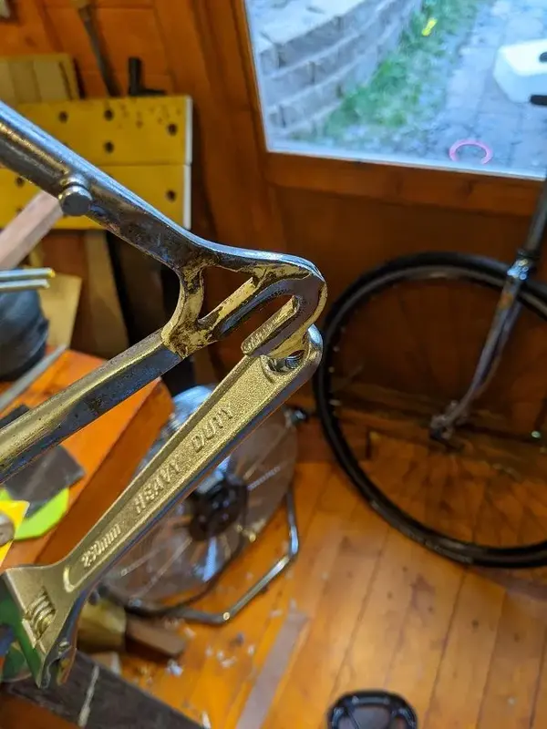

I gather that the rear wheel has been hit slightly from the side (by a car?). The rear triangle has been bent, the non-ds dropout slightly bent inside, while the ds dropout has been slightly bent open. We're only talking a couple mm, so all was fixable.
I've popped my cold-setting cherry using the SB method. The triangle is now expanded to 129mm and trued up. The 129 just happened while I was truing up the stays, and I'm quite happy that I can now install a 130mm hub with ease.
I need to do a final alignment of the drop-outs, but the gauge is still in the post.
The "opened" ds dropout was fixed using a monkey wrench handle - I just filed an oval slot in the handle just big enough to fit the hanger through it, then used the hanger for leverage.

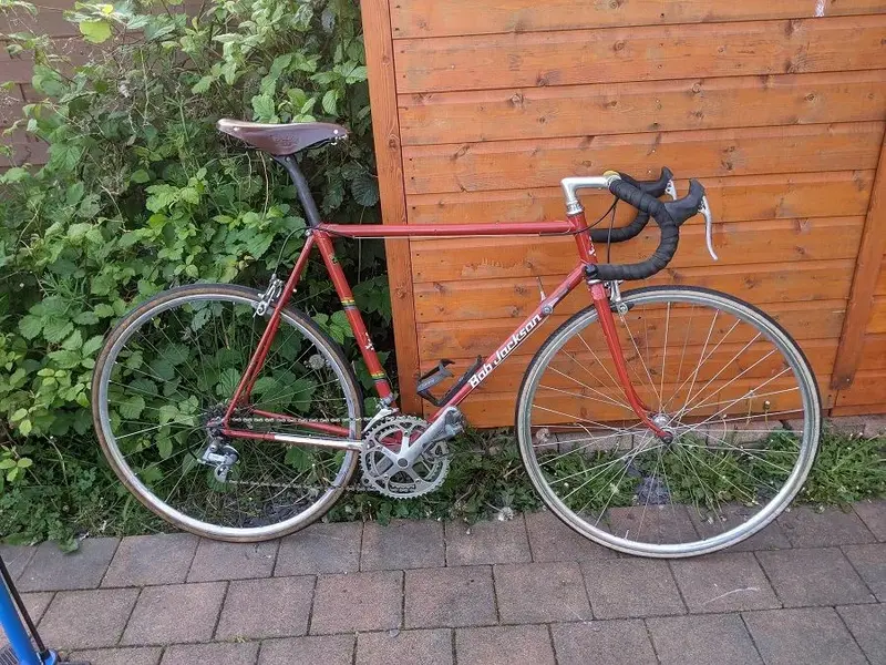

A perfect candidate came up for sale - an old Bob J, just in the right size, slack geometry and plenty of space for guards, panniers and thicker tyres.

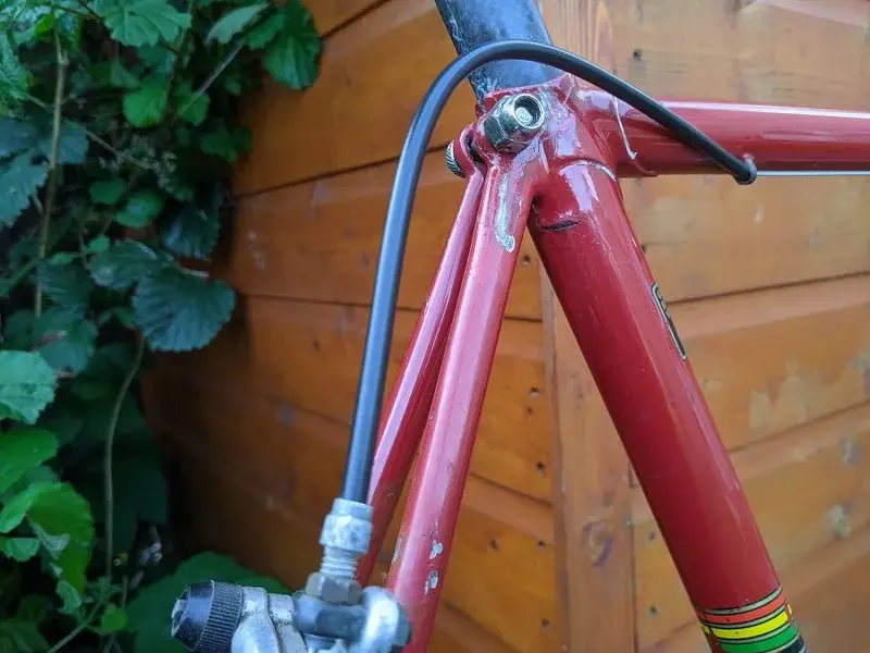

Bought the bike, brought it home, had a good look over it - to my horror found a seatpost crack just under the lug! Seems to have been caused by a too short a seatpost.
I believe in fixing things rather than throwing them away, so can you knowledgeable sirs kindly advise me whether this can be repaired?
I don't expect to be hammering downhill at 45mph on this bike and the damage so far does not seem too critical. I suspect that with a wee patch and a long enough seatpost, this can last for years of commuting. Steel's supposed to be real, right?
