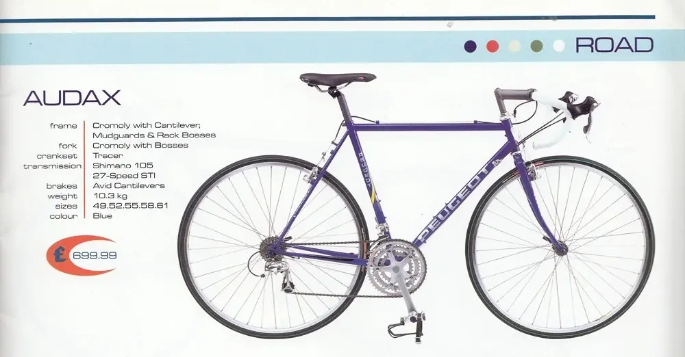

Hello everyone,
I'm considering buying a retro (I believe 1990s?) Peugeot Audax frame. It has canti lugs and decent tire clearance as well as mounts for mudguards and rack.
I don't know, nor the seller is able (or willing) to tell me if the spacing is 130 or 126mm
I'm not against stretching the frame and fit a modern wheel into a 126mm frame, but in practice it is actually quite cumbersome, especially with the old-school semi-horizontal dropouts, and even more when the bike has mudguards and racks.
Also, I never had a vintage frame with modern components. Would I need to optimize the horizontal position of the rear wheel in order for the derailleur to work, or I just need to make sure I push it all the way back into the dropouts?
Thanks!
