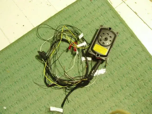

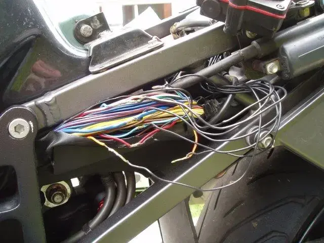

Ha! Finally plucked up the courage to get rid of the bl--dy alarm immobilizer off the Falco. It had decided i was a thief and stopped me going out for a ride last night. Wouldn't stop screeching.
What a guddle of wires and I'm terrified of electrics - black magic as far as I'm concerned.
But now it's gone and the bike started first prod. Beer time!

First thing I do with most of my vehicles is remove any after market alarm/immobiliser systems. Don't need them up here, and sod's law the darn thing will prevent you getting it going in a hazardous situation.
Well done for tackling that with a fear of electricals! At 46 and decades of messing with them I am only just getting confident with auto electrics!
