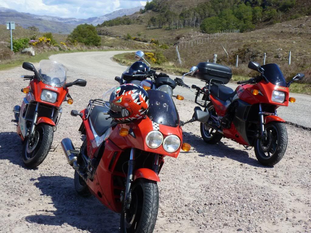

Hope that clatter turns out to be something trivial. Those are usually strong engines. Good to see some other motorised bike enthusiasts here.
SHOOSH! Ye'll get Rob started with his collection of muscle machines :twisted:
And Eck, and Mikee, and.....
