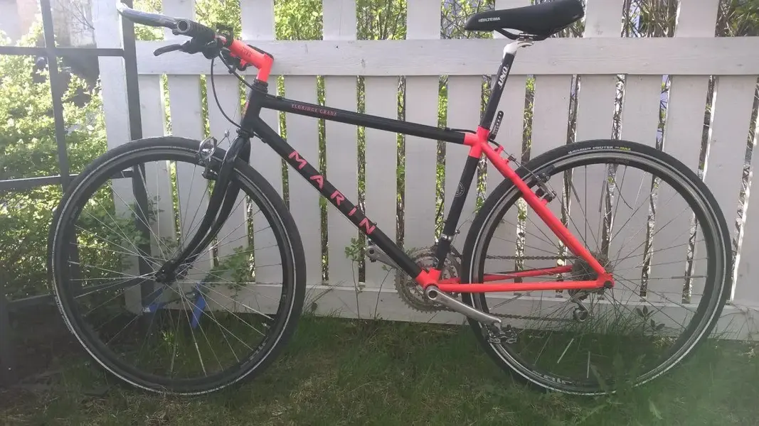

Well, update 1 continues after more than year. Finally I got something to ride. Fork is 28". Wheels are 28". Tires are 32- 622. So front brakepads are now correctly placed. Rear pads are in "tuned position". ;)
Pedals I will change to something else. Rear derailleur needs cable.
Bit wondering driving position but need to make longer run to see how it works.
