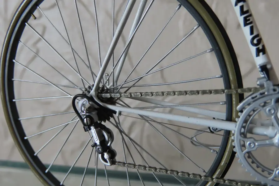

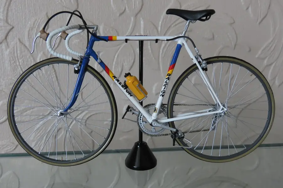

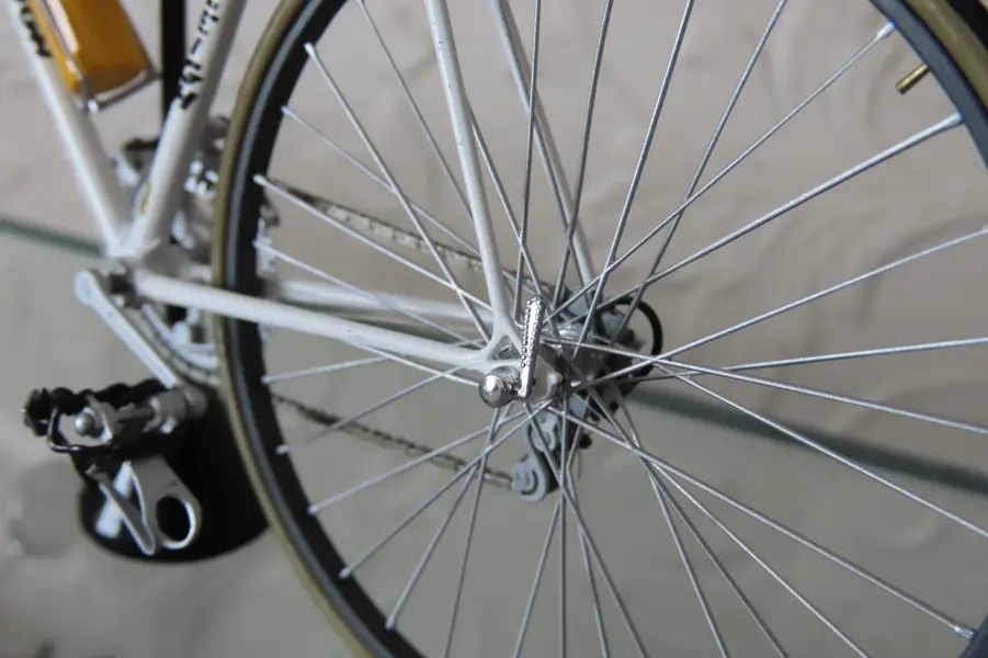

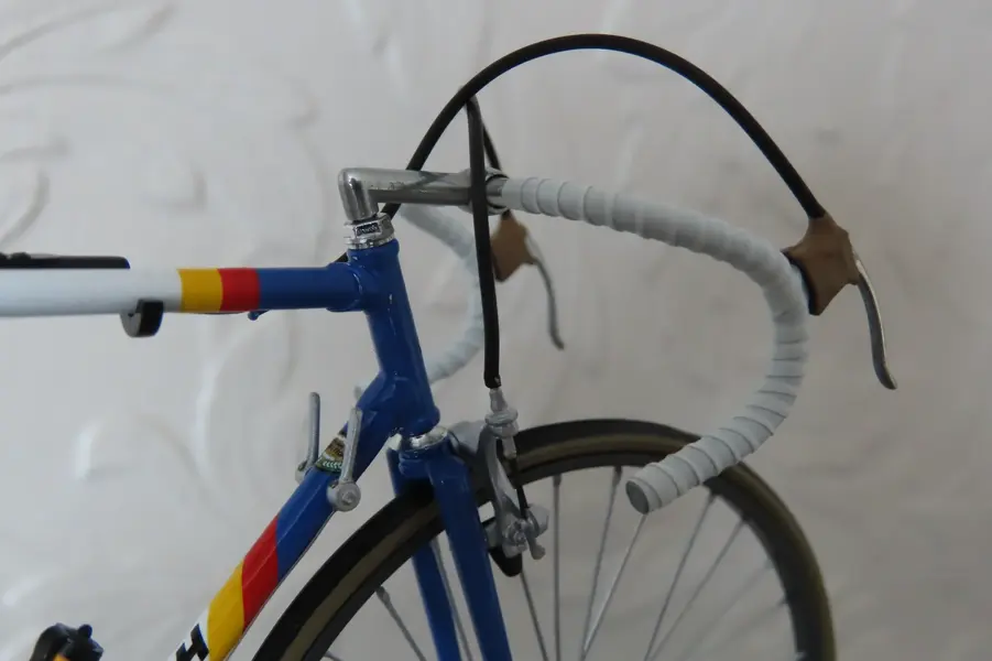

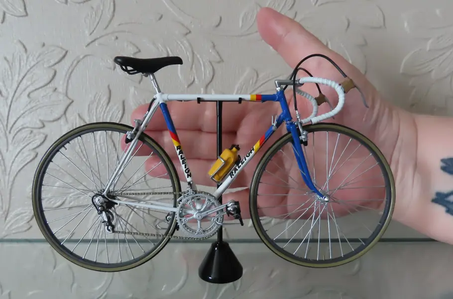

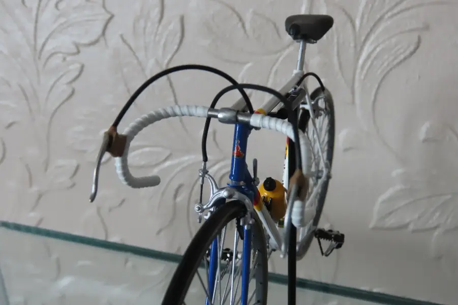

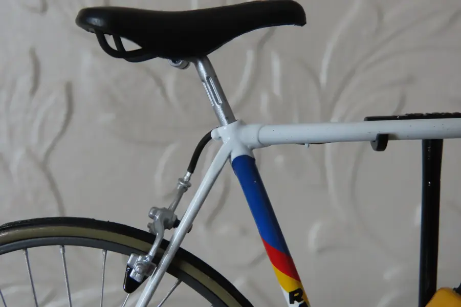

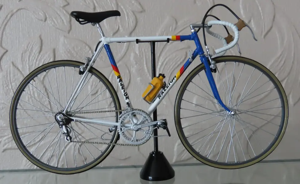

To keep me from cracking up I make models these days, I've had a certain kit for a long time now, just doing a bit at a time, today I've finally finished it.

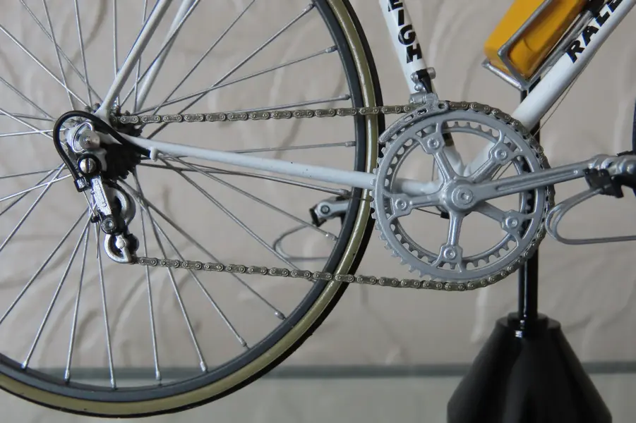

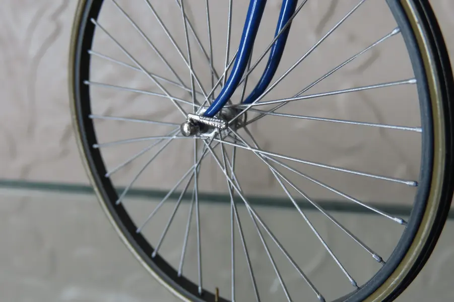

I bet there's no end of you who know of the 1/9th scale Protar bike kits but rarely see them built up, I've really tried my hardest to make it look lovely, this has involved a lot of modifications to the frame - Filling holes here & there and doing away with the oversized clamp on parts and making braze on's for the brake cable stops - Also reshaping the front fork crown to a Cinelli slopped crown look - Reprofiled the handlebar stem & seat post - Making the components more to scale by reducing the plastic thickness - Also the spokes are way too thick and around the hubs the plastic is solid in the spokes, with care I removed all the waste plastic - Spent hours reducing the thickness of the spokes until they was ready to snap on me - The miniature Campagnolo Super Record groupset looks much better too, brake & gear cables changed with much thinner wire - The rubber horrible chain has been replaced by the optional plastic chain which is much more accurate but takes some work to fit over the front chainwheel & rear sprocket on the freewheel - Painting the tyres was a nightmare, they are all black so with a steady hand I painted a tanwall side edge, what a job to do that neatly - The rims are in metallic grey with the white MAVIC logo's on the rims, see if you can spot them, nice touch ?
