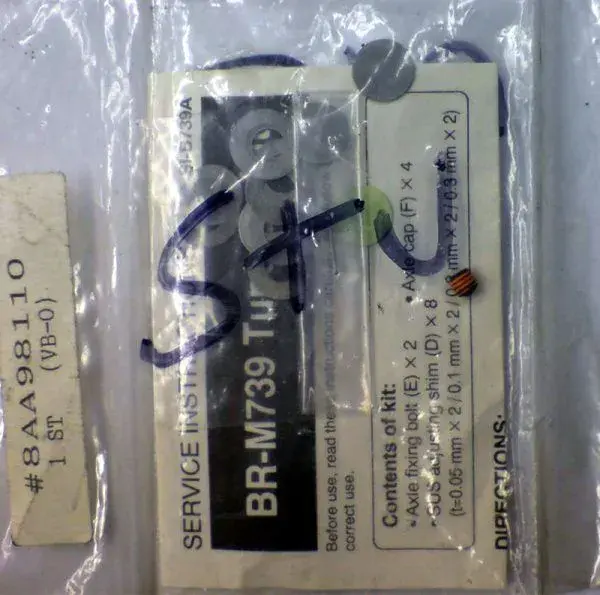

So here are some pics of the original question. shim kits's
anyone got any of the Kit 2 pics and info.

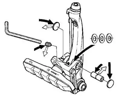

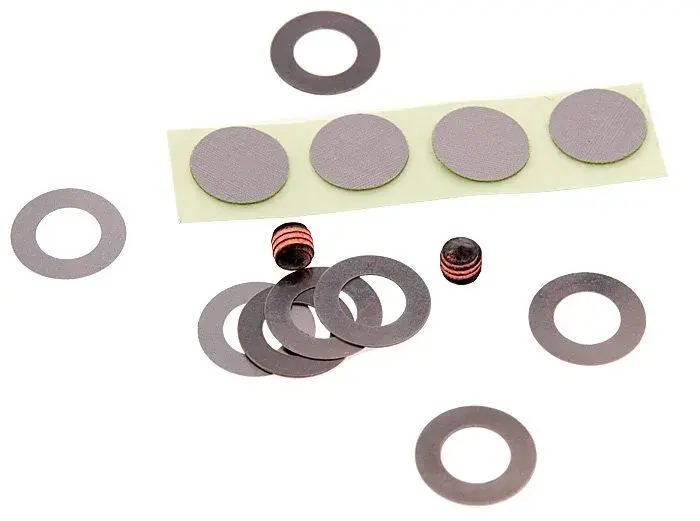

But what are the 'washers' and where are they used ?
Shims are 50/100/200/300 μm

Just read the whole thread... in anutshell there was a flaw with XT v brakes (2002 vintage) wherby they developed a little bit of play around the pivot. The tune up kit basically gave you the bits to take the pivot apart and some wafer thin washers to pack out the gap.
The XTR and LX V brakes at the time where a slightly different design and never developed this play. The next generation of XTs mirrored the XTR design so the tune up kit was only ever aimed at a narrow market.

Just to resurrect this thread; I've got two type 2 kits just arrived from the US. One is XTR grey (didn't realise they did those) and the other is black for the XT brakes.
Anyway, I've scanned the rebuild leaflet in to my album (you'll need to download the original file otherwise it's a bit blurry), feel free to do what you like with it, hopefully it's useful for someone. It also lists what comes in the kit so finding the right shims should be easier.
