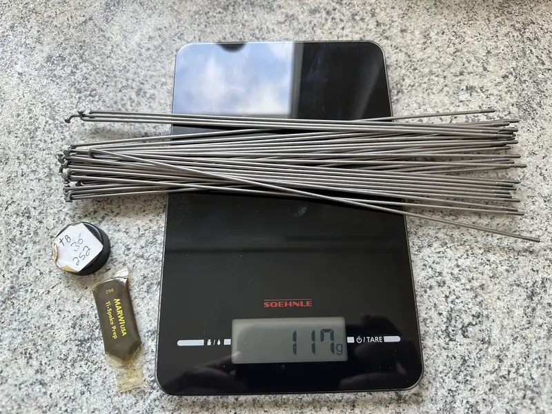

For me and this particular build I am using Marwi Titanium Spokes. For 32 spokes front wheel they weigh 117 grams total and are a straight 2.0 spoke. Straight lace/radial front. Rear spokes are definitely lighter than yours as I used a 3x/radial lacing: 16 spokes at 59 grams, 16 spokes at 61 grams; 120 grams.

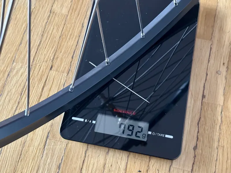

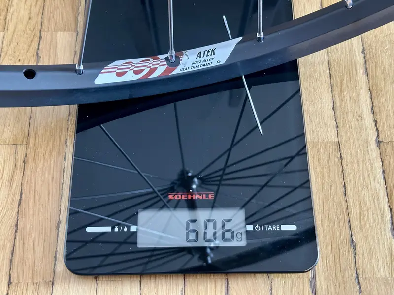

Hmm. If I do the math backwards this means the Atek rim I used for the front weighs 415 grams and the one I used for the rear weighs 423 grams :eek:. The claimed weight from Campagnolo was to be 380 grams a piece. I never bothered to check this before building as I assumed the information to be accurate, but must be due to the Hardox coating adding all this weight, or my scales are broken.

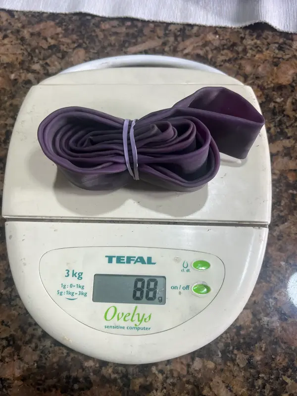

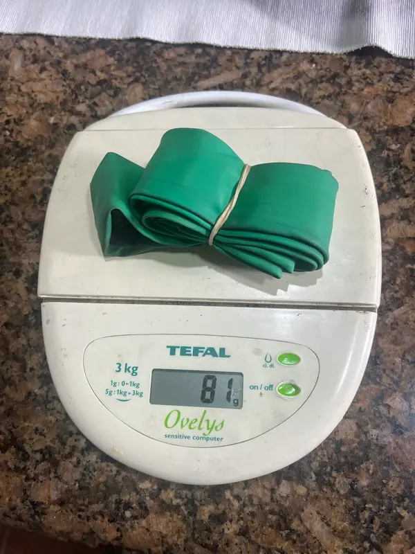

I promised photos of the latex inner tubes I have, but I had a very intense couple of weeks and couldn't get home except to sleep.
Well, "a promise is a promise," the photos.
The purple one is a latex Vittoria. I have about 8, but the last ones I put in last year died when I inflated them.
The green one is DT Swiss. I have a set, but I don't dare try them; I prefer to keep them as a souvenir.
By the way, the DT Presta valve version weighed less than 80 grams. I remember that clearly.

Titanium spokes have always appealed to me; I think they're fantastic work!
The truth is, since I've never used them, I'm afraid of truing them. They're a significant investment, and it would be unpleasant if they gave me problems...
Well, I know I'll put them on a wheel someday.

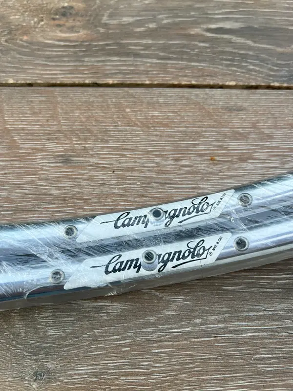

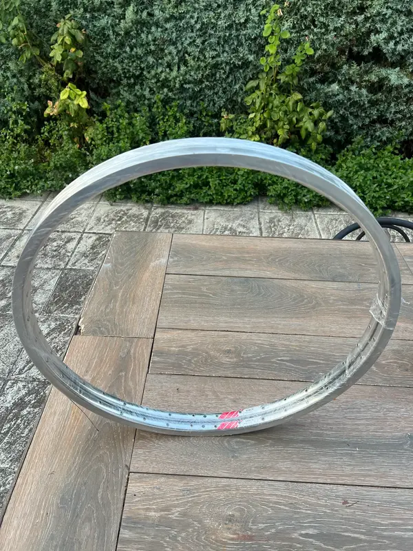

Ah! Campagnolo and their weights, lol!

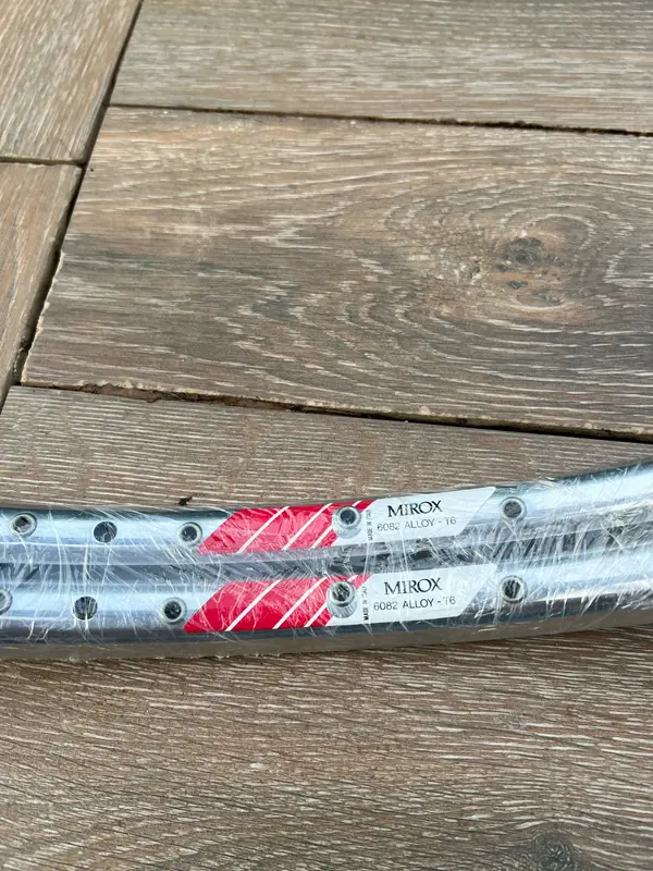

The Atek option is very bold. Not everyone likes using them because of the curved sidewall profile; it requires meticulous pad adjustment.
In return, they're spectacular.
In September, I found some Mirox when I returned to Spain from vacation for €25, and they were 35 km from home. I couldn't resist.
They're beautiful.
