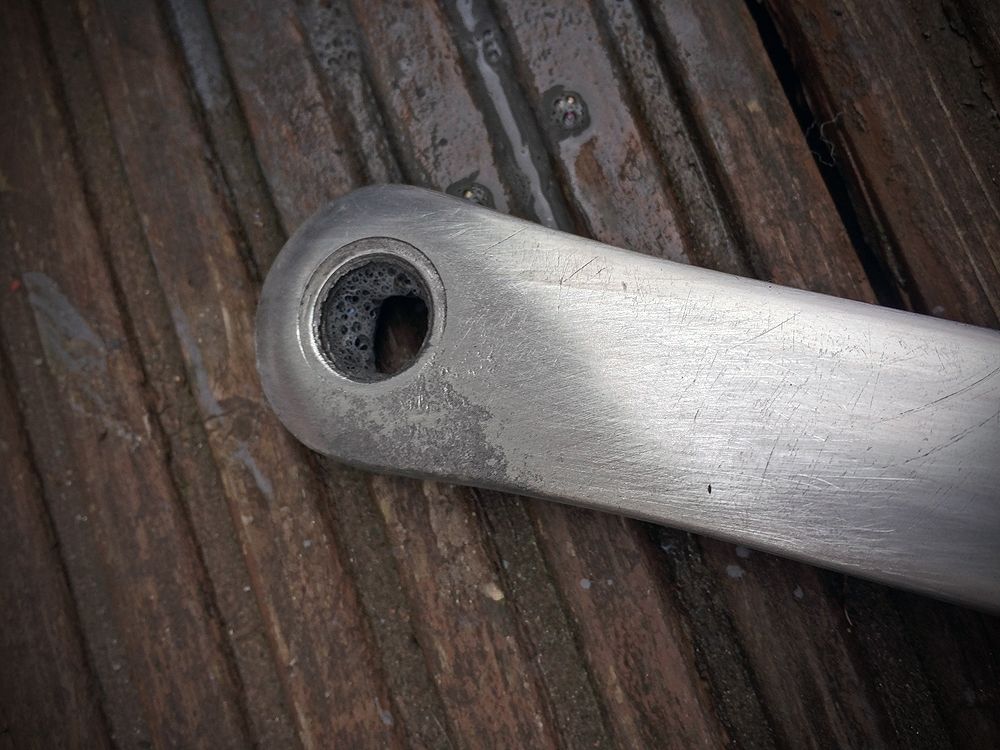

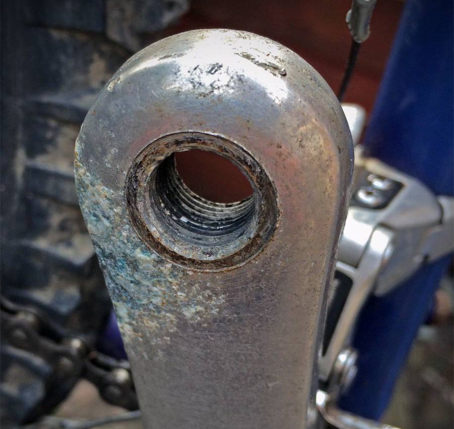

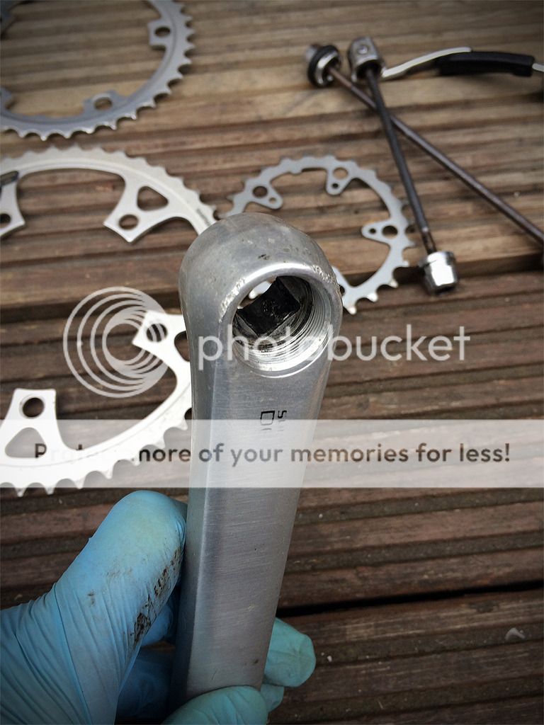

Corrosion was pretty bad, no wonder the pedals were a pain to remove :shock:

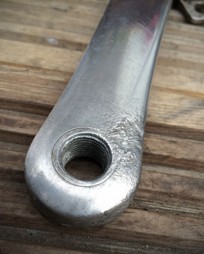

Deep Pitting remains after wire brush drill attachment....
Got carried away with the brush and introduced further scoring into the arm :facepalm:

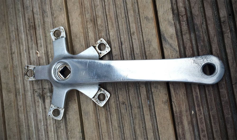

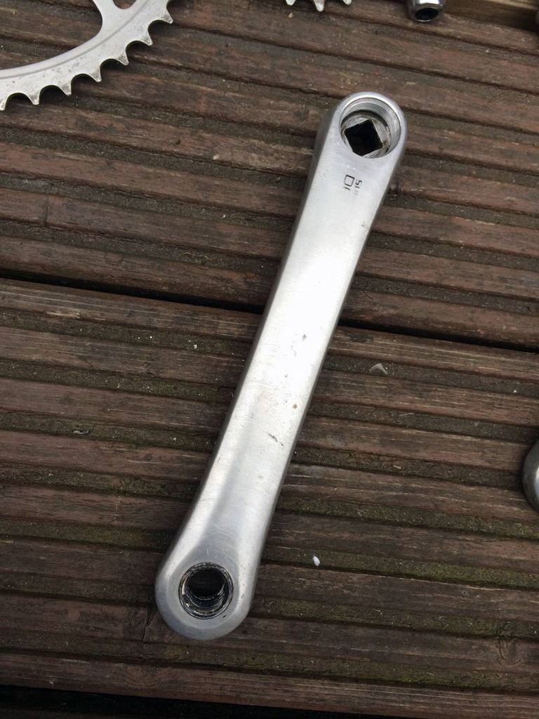

None drive side in better condition....
Few marks around the BB end (these will be sanded out) ....
Sanded with wet and dry ....
Refined with finer grade W&D...

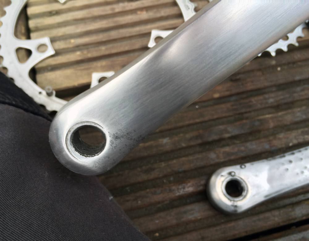

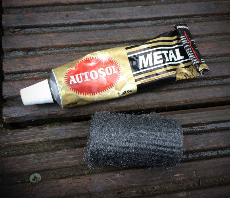

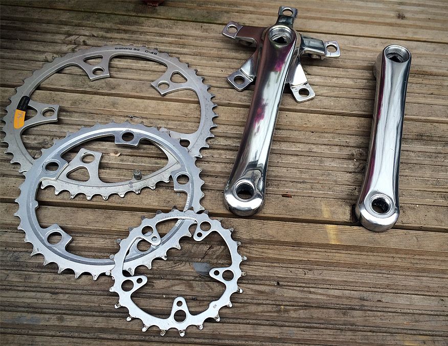

At this stage, realising i probably wouldnt get the surface any smoother without loosing the shape of the arm, i decided to call it a draw with the sanding and move on to the wire wool and Autosol stage....
You can still see the pitting but its a massif improvement over how they were...

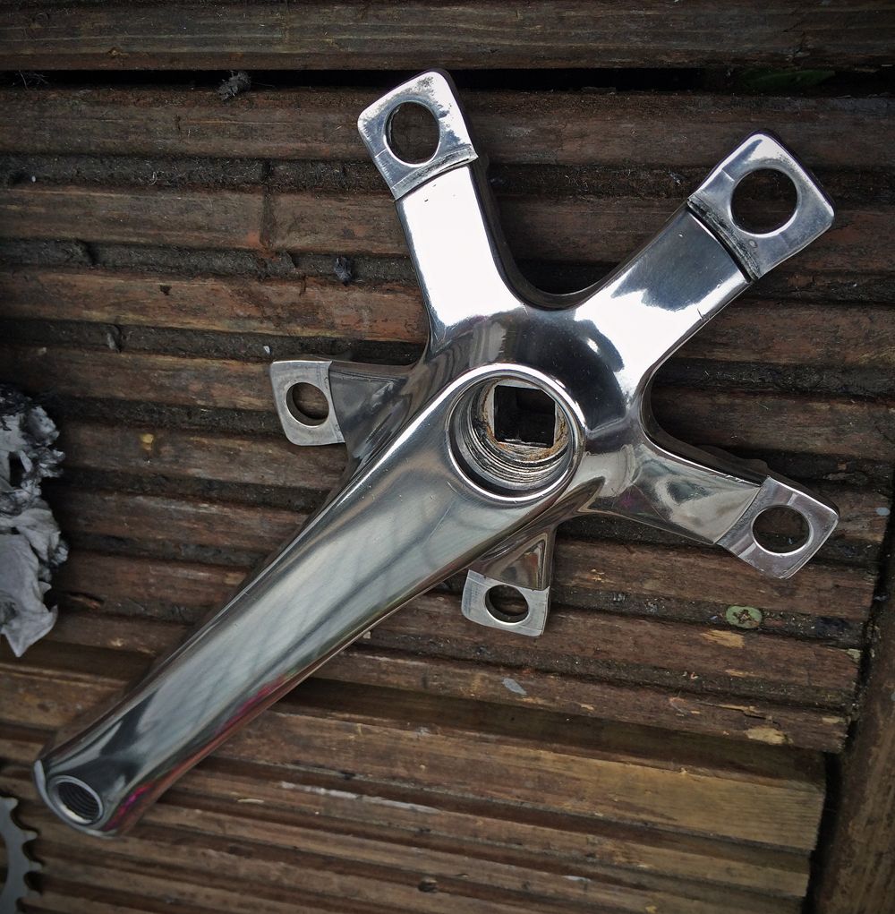

Final polish and finished with Poorboys alloy wheel sealer ...

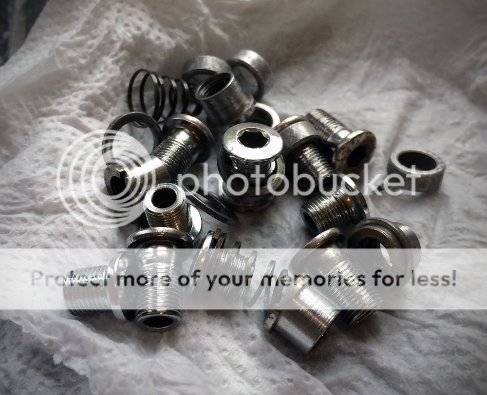

Crank bolts were de greased in paraffin then treated in Bilt hamber Deox Gel to remove rust...
