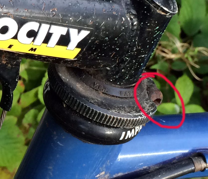

It can be cleaned, but first take a very good look inside the frame.
When it is this corroded it has been outside for a loooong time...

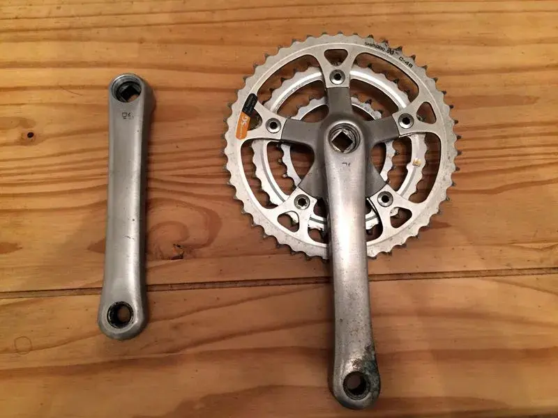

removed cranks

Im guessing its just a matter of loosening this allen bolt and removing the ring ?

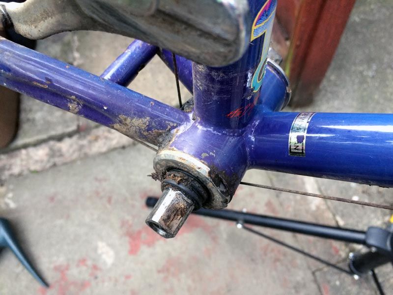

Bottom bracket is old school type !?? not done one of these since the old days (late 1800's :oops: :lol: )
any tips for removal/repair?.... there's slight play in it
Take the stem out, slacken the bolt in the top of the headset a long way then undo by hand. I'd bin the BB after it comes out! Can you take a shot of the un-faded colour, please? I'm try to match to a RAL colour.

yes just undo the allen bolt and unscrew the cup and lockring.

bottom bracket, well what tools do you have.
loosen the lockring, unscrew the cup, take the axle and bearings out. take the fixed cup (one you see in the picture) out too. cheack all bearing surface, throw away if pitted.
then tap the cups out. the plastic cover acts as a seal iirc.

i have one of those 44 pcs bike tool set's from ebay :oops: pretty sure it has big mama spanners in there :lol: do these type BBs tend to stick like the cartridge BB's? can they be swapped out for cartridge BBs if necessary ?
edit: thanks for the link ... removal info i need there :mrgreen:
