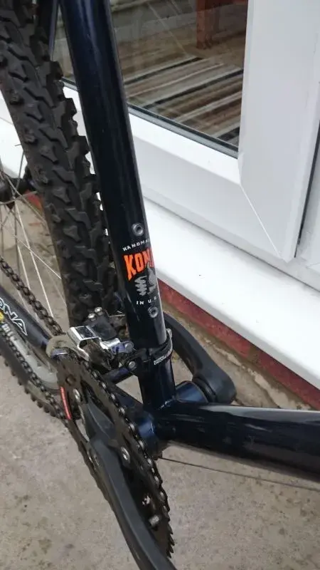

H0 9607032 Different blue, 19", (mrdryskull)
CA 960901# Unknown Blue 19", (Vanlsle)
CA 9609012 Poopsy Blue 16” (Bigttown)

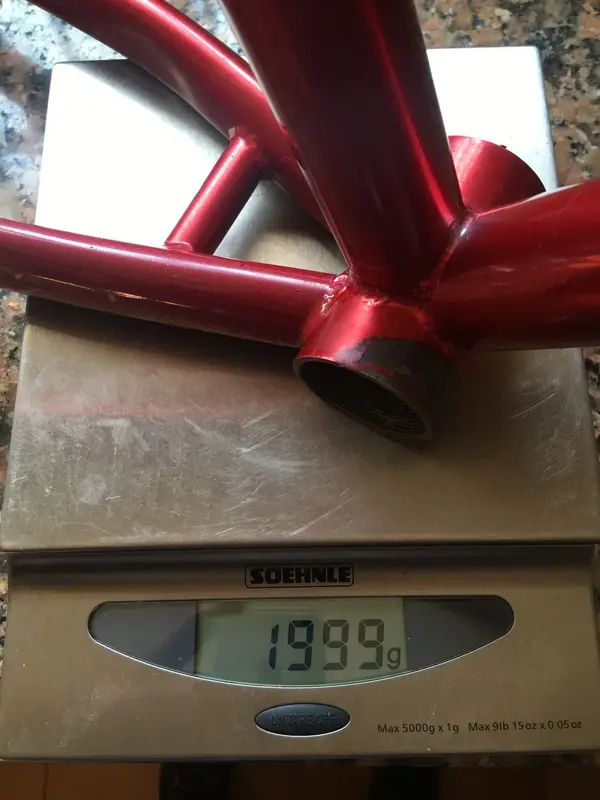

CA 9609021 Molotov Red 16”, no seat-tube bulge, 1,999gr, (elmadu)
CA 9609046 Poopsy Blue, no seat-tube bulge, 20" (al-onestare)
CA 9609064 Molotov Red, 20" (H1v9a8c:cool:
CA 9609109 Molotov Red, 19" (maxwellllll)
CA 9609126 Molotov Red, no seat-tube bulge, 19" (murphy79)
CA 9609144 Molotov Red, 18", (knickering)
CA 9609158 Poopsy Blue, 18" (Mike Kizer)
CA 9609181 Molotov Red, 18" (Jacob)
CA 9609188 Poopsy Blue, no seat-tube bulge, 18" (Troy Douglas)
K0 9610031 Poopsy Blue, 18", seat-tube bulge, (formerly H1v9a8c8 now Konaman1)
K0 9610032 Poopsy Blue, 19", (Nathan99)

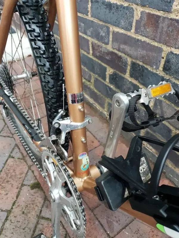

Not CA9609021, E-Bay listing Molotov Red 16”

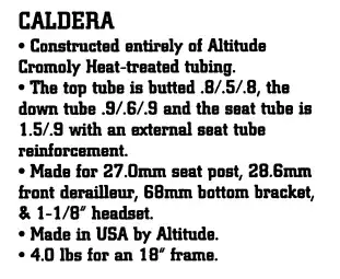

1997 dealer spec sheet recently uploaded by TiHardtail to this site has this to say about the Caldera:
Pip had mentioned that some early frames had a bulge. It appears the "production" frames do not but we've added it as a criteria item for future additions to the serial number list.

• elmadu: CA9609021, Molotov Red 16” 1,999gr

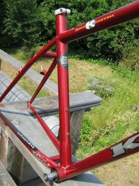

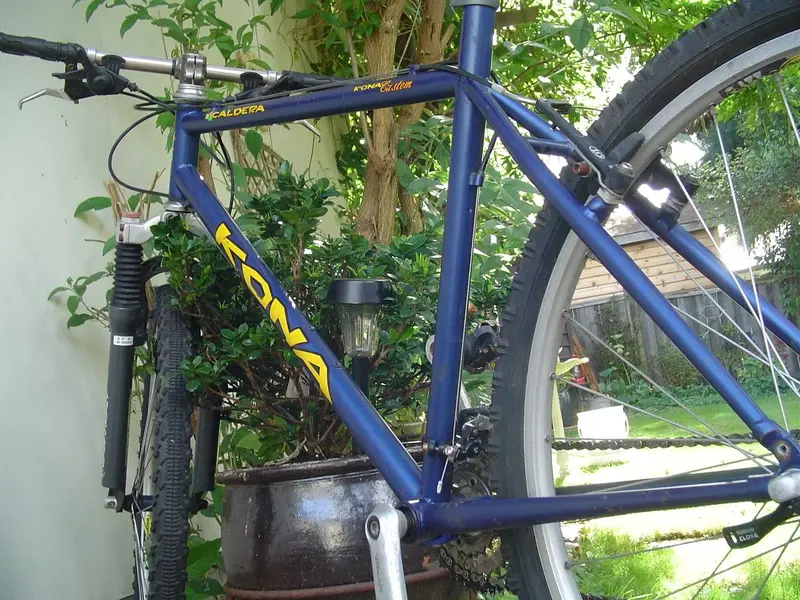

Moving on; has anyone noticed the variance in the Seat Tube Bulge of the Tange Tubing at the Bottom Bracket junction?
The Ultimate Ultrastrong Tubing seems to be more elongated up the length of the Tube, and slightly wider, when compared to the Prestige Concept. These two version in turn look different from the Seat Tube Bulge seen on some (but not all) of the Caldera Tubing, i.e.
Konaman1 K0 9610031, Poopsy Blue, 18" - well by my tired old eyes they do anyway.
See examples below.

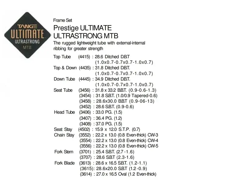

Tange Ultimate Ultrastrong:

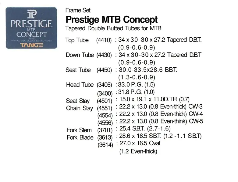

Tange Prestige Concept:
Aledgedly "Altitude" Heat Treated Cromoly:
Then there are the Poopsy Blue, and Molotov Red versions with no Seat Tube Bulge at the Bottom Bracket Junction, which have alowed a Low Clamp Front Mech to be fitted:
al-onestare: CA 9609046, Poopsy Blue, 20"
elmadu: CA9609021, Molotov Red, 16”

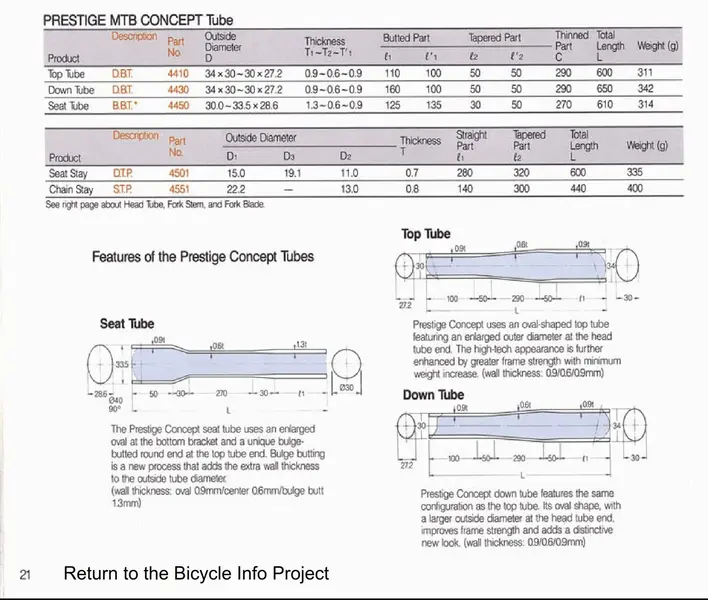

Finally here is a snippet from the 1992 Tange Catalogue that explains the tubing Butting and Seat Tube Bulge - albeit a little difficult to understand 🧐:

About the tubesets, are the Caldera's full Prestige tubing? I have noticed the difference in the external bulge on various years of Kona, experimenting with different weights and flex maybe, or maybe some are not Concept, as in lower end Kona's with bulged Tange seat tubes? Also the Ultrastrong frames, i thought the seat tubes were Prestige Concept with the down tube being Ultrastrong. And as far as i am aware, and your Prestige tube sheets seem to confirm that, tubes without the seat tube bulge are not Concept.
I’ve been trying to compose something here for a few days now, and I am struggling for a couple of reasons. Namely, I’m obviously a bit under the weather and on some fairly heavy gear to help with that. I'm finding it somewhat complicated trying to figure out these different types of tubing from the pictures and documentation that I have…... anyway;
Tange seem to have one of the most comprehensive ranges of different tubing, based on quality over cost and function, all of which is making identifying the tubing used a bit tricky. I will say though in answer to your question.......
I am currently unable to find it documented that the Caldera used Tange Prestige MTB Concept Tubing, or indeed any of the Tange range.
From the 1997 Catalogue, and Pricelist:
“Altitude Heat-treated Cromoly tubing” Page 9 of the 1997 Catalogue.
“Altitude Cromoly Heat-treated” Page 30 of the 1997 Catalogue.
“Altitude Heat-treated Cromoly” Page 3 of the Kona Pricelist 1997.
So hopefully without appearing to cop out on the research here, I think the best move now is to compare the various pictures that I have of the seven confirmed Caldera frames, (and the various Hot frames using Tange tubing), along with the Tange Catalogue, then bat the answers back to some questions as people come up with them.
