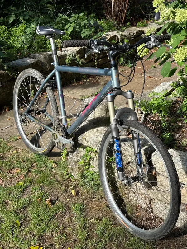

Just picked up this stumpy and plan to do a resto on it. I’d like to replace the decals but I’m having trouble tracking them down so if anyone can help out I’d appreciate itView attachment 985534View attachment 985535View attachment 985536View attachment 985537View attachment 985538

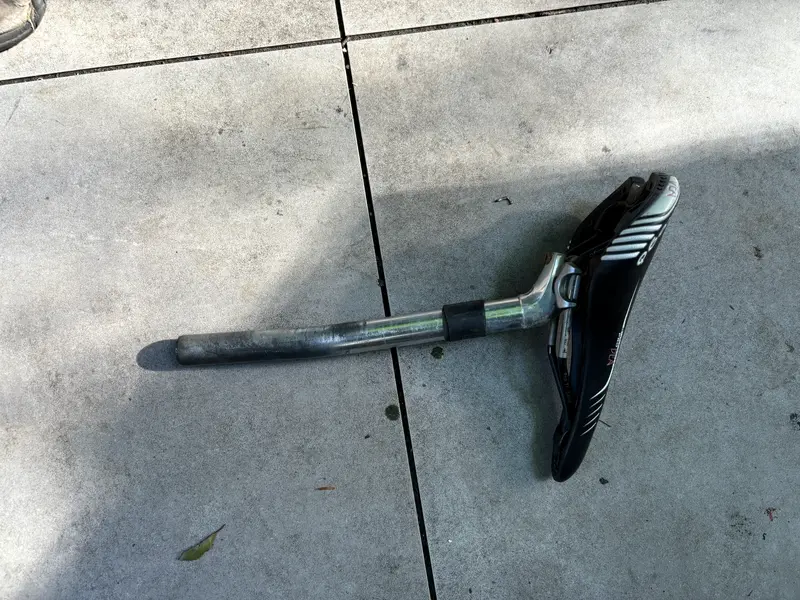

Apart from the seat post maybe. How do poeple manage to do this?

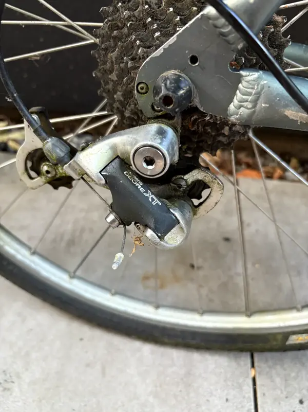

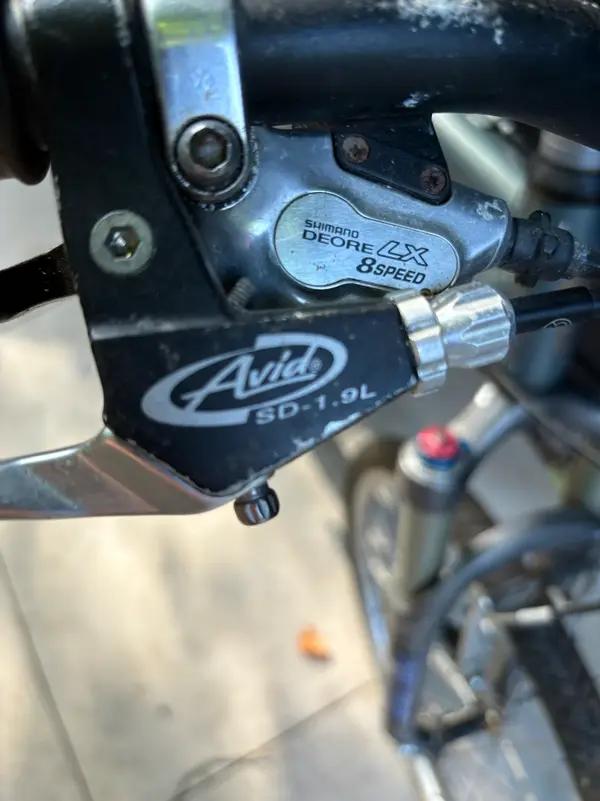

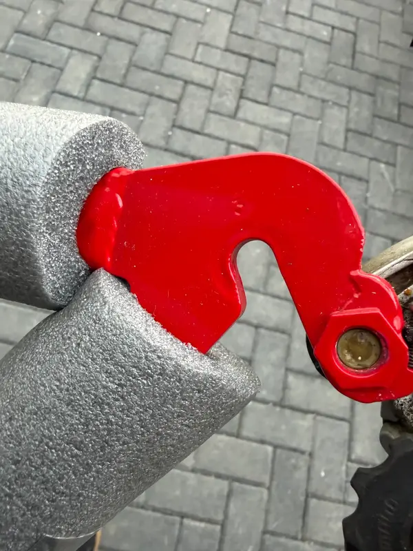

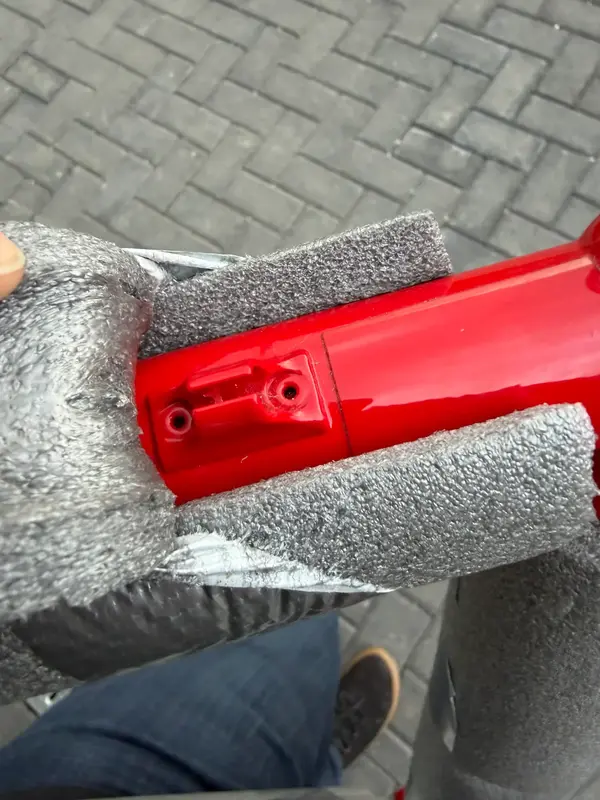

Phew, all stripped down and frame washed, it is always a relief when you get to this stage with no major problems. I first thought the seat post was stuck and it did require a bit of brute force to remove but that was because it was bent rather than stuck, and i wasn't that worried since an aluminium post in an aluminium frame is usually not a major issue. Then as I take out the various allen screws in the frame, "will they won't they come out clean" runs through my head! All fine but the gorilla who tightened the cable retaining screws on the v-brakes needs a torque wrench...I've never come across ones quite as tight before, it's a wonder he hadn't stripped the alloy threads in the brake arms.

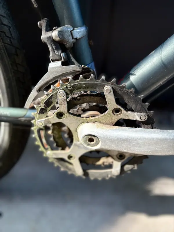

Then the crank arms, I've had to take the angle grinder to more than one set of those, but these were fine. And finally the bottom bracket...will it or won't it play ball, and this one was perfect, came out like a well-greased BB should! As I washed it down, I checked for dents and though there were scratches, I could not find any. And I just love an M2 frame which means the scratches stay nice and clean!

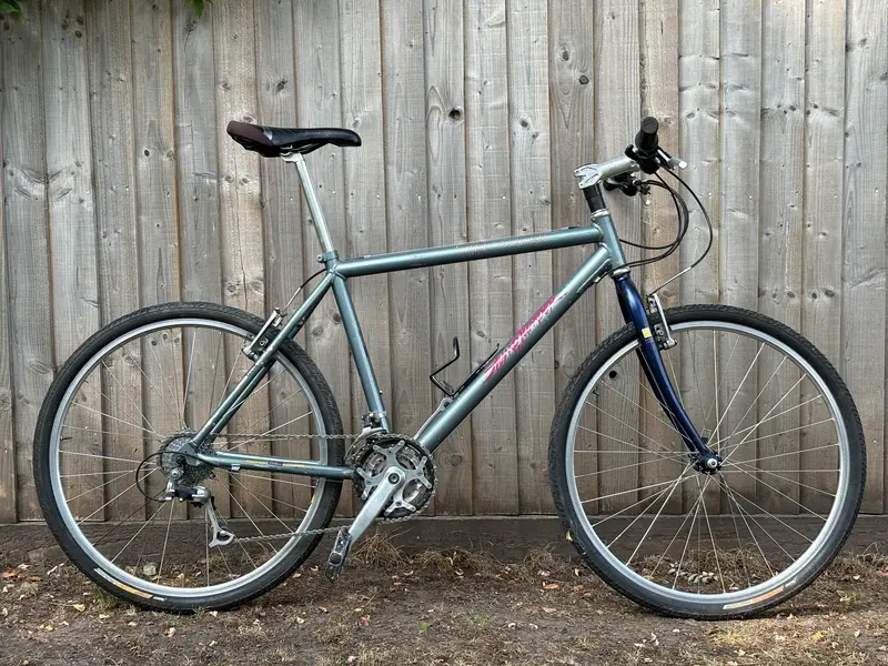

Here it is in all its glory. I could just clean and lube everything, put in a new seat post and chain and be riding it this afternoon. IMG_3490.webp IMG_3491.webp IMG_3494.webp IMG_3492.webp
Here it is finished for the moment as a rider for me. Took off the Fox forks, I have another bike in mind for those. I had these Rockhopper forks that apart from the colour are a good fit giving me a bit of stack height since the bike is 19" rather than the 20" I usually ride. Then a new headset, new chain and new brake pads and a change to the saddle to a Specialized (non period) and the job is done. Total cost not into three figures.
EDIT : I forgot I had to replace a broken spoke too but I had one the right size!

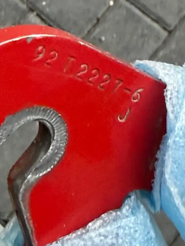

Wow! That’s one of the first 500 Team Edition M2’s. It should be a 1992. I am still not sure what is different between these first 500 and the later 1992 Team’s, but the cable guides on the earlier ones are riveted, like a 1991 (which would be consistent with the 1991 SN). That build is clean too!
Just to clarify—Specialized only produced 500 of the 1992 S-Works M2 Team frames, all in Fire Engine Red. If this is one of them (which it certainly appears to be), then it’s part of an exceptionally rare batch. The Retrobike registry and MTBR threads confirm that this limited run was built to honor Ned Overend’s race rig. Definitely a collector’s gem—and a piece of Specialized history.
