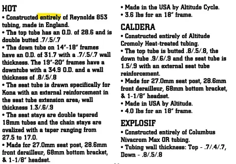

1996 & 1997 Altitude Cycle Technologies: Chico. California.
The 1996 & 1997 frames are made from Reynolds 853 Butted Main Tubes, and rumoured to have 725 Stays.
Dropouts on some early 1996 Altitude Hot frames have a similar flat design to the later TET frames - these frames have one Rear Brake Cable Stop at the front of the Top Tube & require a Dog Collar, with Down Tube routing for the Front and Rear Mech.
The later 1996 Hot frames have Goathead Investment Cast Dropouts – these frames have two Rear Brake Cable Stops on the Top Tube, with Down Tube routing for Front and Rear Mech.
Serial Number format 1996 frames - HT### & HT0### (currently with one exception).
The 1997 frames also have Goathead Investment Cast Dropouts, but with two double Cable Stops on the Top Tube at the front and the rear for the Front Mech and Rear Brake, with Down Tube routing for the Rear Mech.
Serial Number format 1997 frames - H096MM###.
