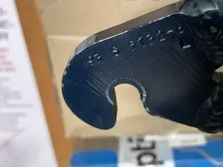

1992 S-Works M2 Team, 18”? — 92T1744-6 L
1992 S-Works M2 Team, 18” — 92T2735-6 J

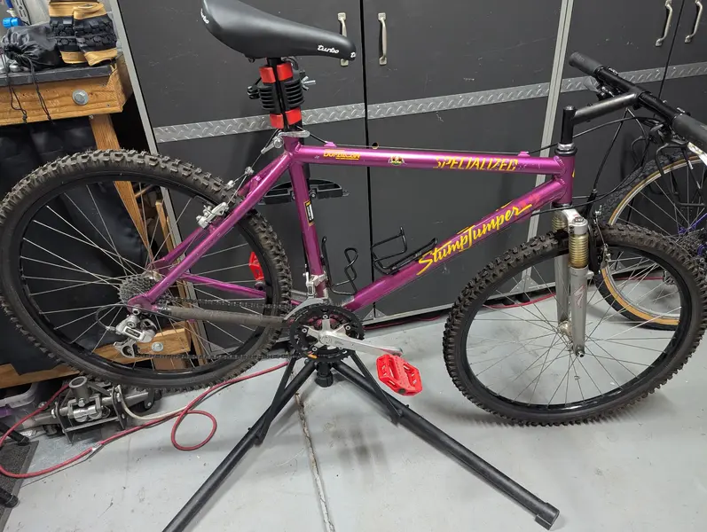

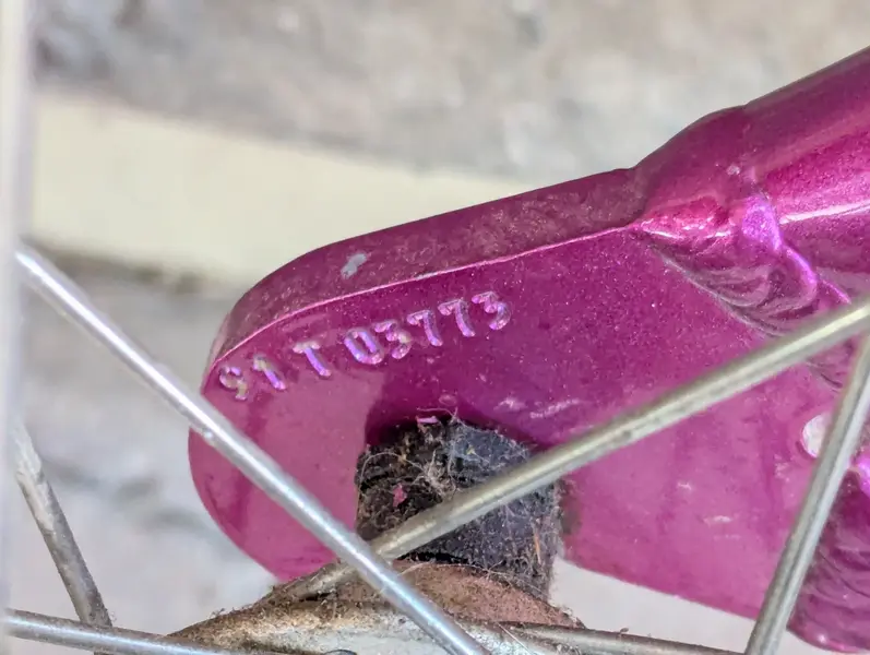

i just picked this up for a song... Can you tell me anything else about it?
1991 Stumpjumper M2 FS, 18" - 91T03773
I'll post up some pictures once I remove some random accessories and a clean.....
UPDATE: So, no dents....just scratches from bouncing around the previous owner's garage. Its mostly original, however I think the Future Shock was added after the fact. The stem has the pass thru for the front brake cable (which is unused in the picture) and the shifter/lever combo is black LX, I believe a newer generation than the original Deore DX drivetrain. Not looking forward to rebuilding the FS fork, it doesn't rebound at all. And yes, those pedals came w/the bike. Lastly, I switched out a giant gel saddle for a repop Turbo laying around. I love the looks of this bike and looking forward to fixing all the little stuff.
Thank you! Rich

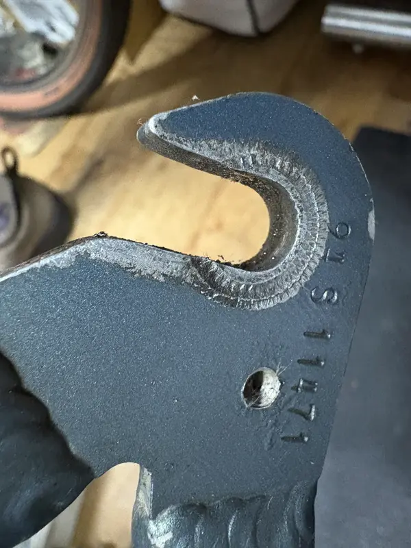

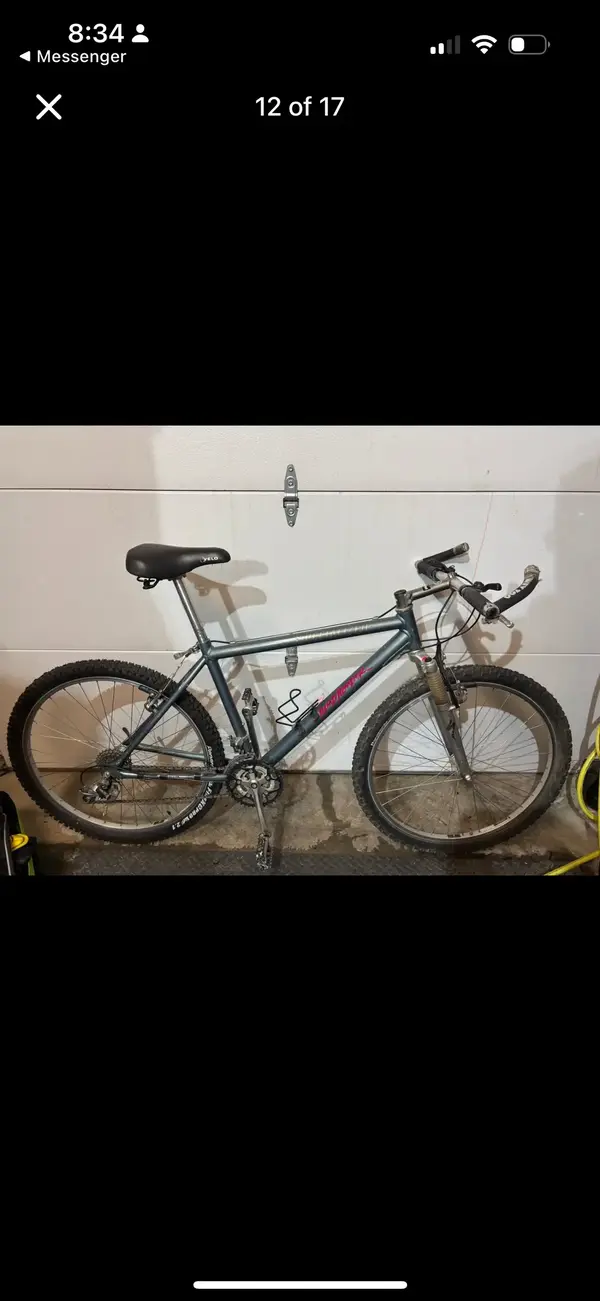

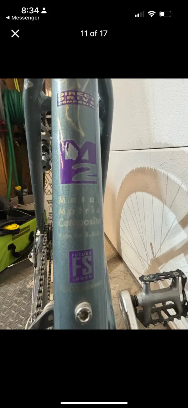

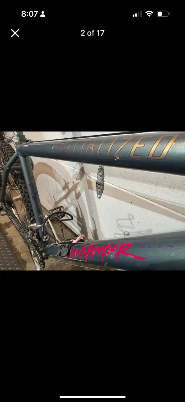

Anyone any idea what year this M2 is. It is not in my possession yet so i can't tell the serial number.
I have it now... It's better than I thought, I will have a proper look tomorrow but it actually seems to have mostly original parts and the frame has scratches but no dents.
